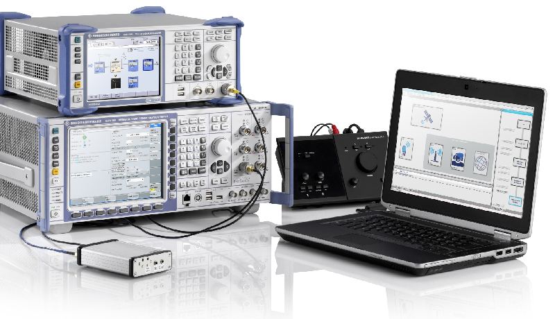

At Mobile World Congress, Rohde & Schwarz is demonstrating an ERA-GLONASS test setup consisting of the R&S CMW500 wideband radio communication tester and R&S SMBV100A vector signal generator as a global navigation satellite system (GNSS) simulator. This setup allows manufacturers and suppliers of automatic in-vehicle systems (IVS) to perform reliable and reproducible preconformance tests on their ERA GLONASS modules in the lab.

Rohde & Schwarz developed its R&S CMW-KA095 application software to meet ERA GLONASS requirements in line with Russia's GOST specification. Based on the R&S CMW-KA094 eCall software, the R&S CMW-KA095 simulates a PSAP and controls the R&S CMW500 emulating a wireless communications network in the lab. The software also controls the GNSS simulator that supplies the coordinates required for vehicle localization. With this solution, users can verify whether their IVS modem is able to successfully initiate an emergency call, transmit the correct MSD and establish a voice connection with a PSAP. The results are interpreted in line with the GOST specification. The ERA GLONASS SMS protocol has also been integrated into the test solution, making it possible to test the SMS functionality of the IVS modem when no voice connection is available – does it correctly send SMS messages and send an SMS in response to remote PSAP commands?
The test solution is fully automated thanks to the R&S CMWrun sequencer software. The R&S CMW-KT110 eCall/ERA-GLONASS test package provides a user friendly, automated functional test in line with GOST55330, enabling users to verify the operability of an entire system in the lab and document it in a report.
