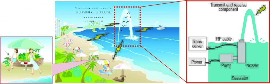

Mitsubishi Electric Corporation announced that it has developed an innovative antenna system, called SeaAerial, that shoots a column of seawater into the air to create a conductive plume for the transmission and reception of radio-frequency waves. The system can be easily implemented offshore or along shorelines. SeaAerial is thought to be the world’s first seawater antenna capable of receiving digital terrestrial broadcasts for normal viewing.
A plume of seawater can be used as an antenna if it is insulated, so Mitsubishi Electric developed an insulated nozzle that transmits radio waves to the antenna even when the plume is physically connected to the sea surface. Effective insulation is achieved with a quarter-wavelength tube in the nozzle.
Mitsubishi Electric's SeaAerial Antenna Uses Seawater Plume
One of the challenges was to secure antenna efficiency, or the ratio of radiated power to input power, because seawater is much less conductive than metal. Mitsubishi Electric used simulations to determine the ideal diameter of the plume, resulting in an efficiency level of 70 percent, which is sufficient for transmitting and receiving signals.
The size of an antenna is usually determined by its operating frequency, so the height of a low-frequency antenna can be up to tens of meters in some cases, requiring a complicated configuration and a huge structure for support. Finding a fixed place to erect such a large antenna, as well as moving it to another location, can present many problems. SeaAerial, despite its size, can be installed virtually anywhere along the shore, as well as offshore, and it can be moved easily by ship and other vessels because basically it requires just a pump and an insulated nozzle.
