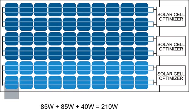

Our solar cell optimizers embed the maximum power point tracker (MPPT) function deeper in the photovoltaic system than ever before. You’re no longer constrained by the limits of conventional design or panel-level optimization. No more costly boxes hanging off the back of your panel, no more network cabling or communications gateways, and no more hotspot module stress. Solar cell optimizers enable you to perform MPPT and DC optimization on each cell string. This granularity minimizes power degradation due to shading, soiling, and other sources of mismatch within the panel.
Solar Panels Gain 30% Additional Power with Maxim's Cell-String Optimizer

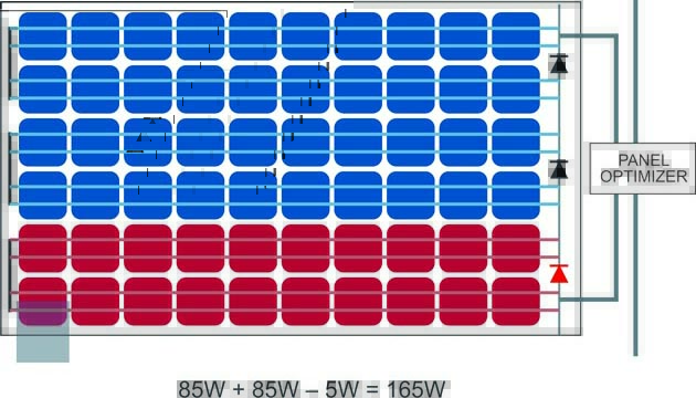

Maxim's cell-string optimizers are highly integrated DC-DC converters that replace the bypass diode and perform maximum power point tracking (MPPT) deep inside the PV module. By replacing each diode with a MPPT device, the on-off response to performance mismatch is eliminated; every cell-string contributes maximum power without interfering with the power production capability of others. This enhanced degree of flexibility leads to increased energy production; eliminating collateral performance loss due to module mismatch, degradation, soiling, localized shading, and row shading loss mechanisms.
