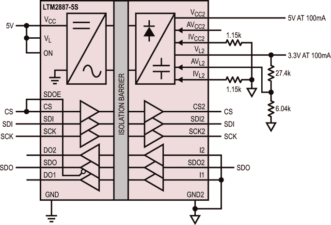

| Typical Application: Isolated 4 MHz SPI Interface. |
