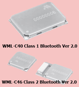

Mitsumi introduces Bluetooth module supporting ver. 2.0 + EDR WML-C40*N / WML-C46**N. These products are Bluetooth modules, whose concept is placed on replacing existing models and high speed rate power saving, supporting the new Bluetooth standard Ver.2.0 + EDR. By matching the sizes, foot patterns, and arrangement of both Class 1 and Class 2 with the previous modules of the previous standard (Bluetooth Ver.1.2), the new products are made replaceable with the previous models.

  4. Class 1 and Class 2 are supported. Class 2 with antenna model is also available.
