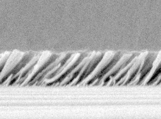

Layer of nanorods deposited on a surface at an angle of 45° form a layer with a refractive index very close to that of air. Depositing a series of such nanorod layers, each with slightly larger refractive index, they reduced the surface reflectivity further still. This meant there were no abrupt refractive-index changes between the air and the coated material - a slab of aluminum nitride.
New materials
A type of material known as aerogel – a foam-like lattice of glass filled with air bubbles – can reduce a material's refractive index further still, but it is impossible to create thin coatings from this. But the angled nanorods can be formed in incredibly thin coatings.
Like aerogels, the nanorod layer is full of voids. This reduces the refractive index of materials to just 5% above that of air and opens the door to novel materials with useful optical properties, the researchers say.
As well as boosting the efficiency of silicon solar cells, allowing them to absorb more light energy, the coating could reduce reflective losses in devices like LEDs. The new materials could also improve photographic lenses and mirrors that selectively reflect specific wavelengths.
Internal structure
The internal structure of the nanorod coating is smaller than the wavelength of light, making it act like a very low density solid. Crucially, the coating cuts reflections of all wavelengths and angles of light. Existing anti-reflective coatings are typically optimised for one wavelength.
