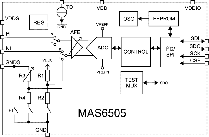

The device uses analog front-end (AFE) comprising of a chopper amplifier with very low noise performance (0.27 µVrms). Analog-to-digital converter (ADC) employs a delta-sigma conversion technique to achieve high resolution (22-bit). It can operate from very wide range of supply voltages (1.71 V…5.5 V) and it has extremely low current consumption (down to 0.8 µA, one measurement in a second) which make it an ideal solution for battery powered applications. Two different temperature sensing methods are supported; sensor bridge resistance sensing or using external temperature sensing diode. 512-bit EEPROM memory is available for storing sensor trimming and calibration coefficients on chip. The device is operated using standard I2C and SPI serial bus interfaces.
MAS6505 block diagram
MAS6505 block diagram.
