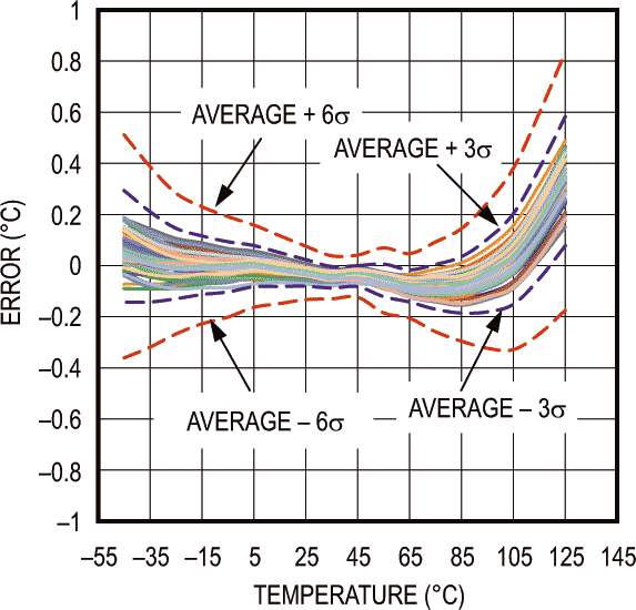

Accuracy vs. Temperature
Accuracy vs. Temperature (VDD = 3.3V 59 Units).
