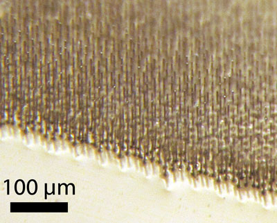

Photomicrograph of a silicon wire array embedded within a transparent,
flexible polymer film. Credit: Caltech/Michael Kelzenberg
California Institute of Technology (Caltech) researchers said the wires are made up of 98 percent plastic, potentially lowering the cost of photovoltaics by using just 1/50th the amount of semiconductor material used today. In tests, the experimental solar cells demonstrated over 90 percent quantum efficiency.
"By developing light-trapping techniques for relatively sparse wire arrays, not only did we achieve suitable absorption, but we also demonstrated effective optical concentration," claimed Harry Atwater, director of Caltech's Resnick Institute.
The silicon wires measure just 1 micron in diameter, but can be as long as 100 microns and can be embedded in a transparent polymer. Light is converted into electricity only inside the wires, but light not immediately absorbed bounces around inside the matrix until it enters another wire. The result, researchers said, is both high concentration and high efficiency in the material.
