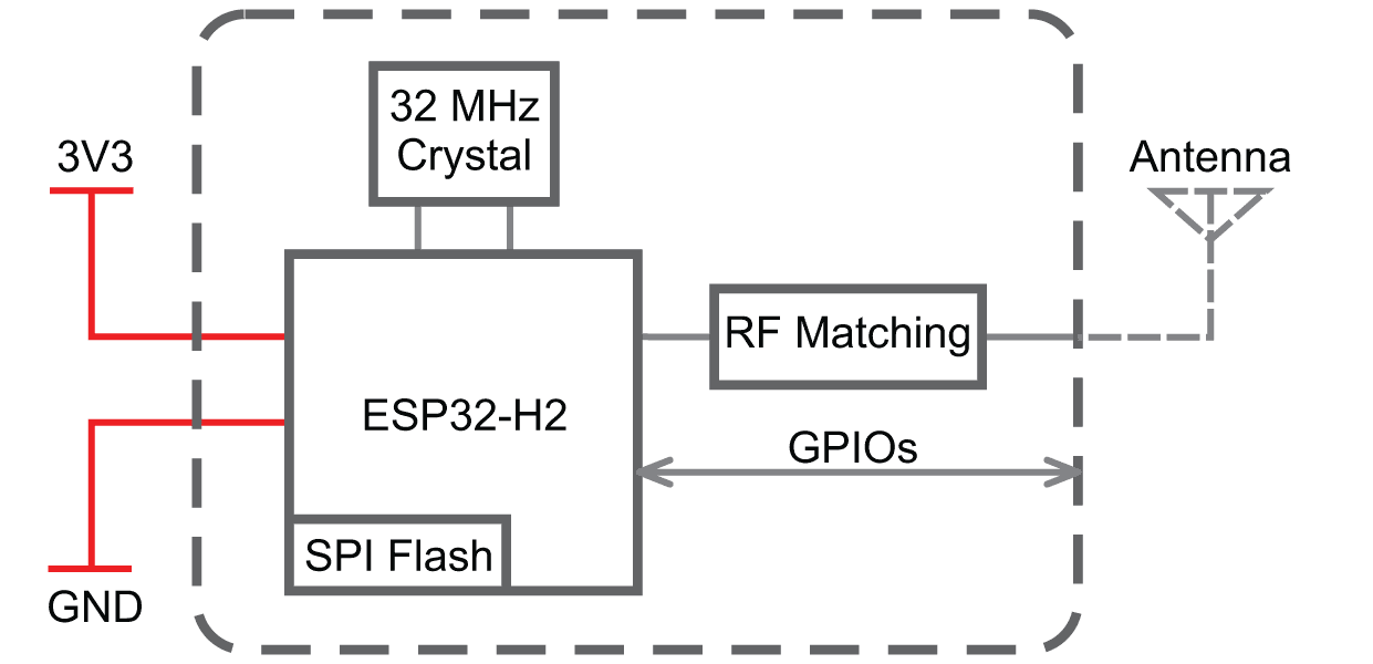

The tiny module, brought to our attention by Linux Gizmos, measures just 8.5×12.7×2.6 mm and, admittedly, is a little lacking in general-purpose input/output (GPIO) pin-count compared to some of Espressif's other designs with just three pins brought out. These are driven by the on-board ESP32-H2 system-on-chip with a single 32-bit RISC-V microcontroller core running at up to 96 MHz, 320 kB of static RAM (SRAM) plus 4 kB of low-power RAM (LPRAM), 128 kB of on-chip flash and either 2 MB of 4 MB of in-package SPI flash depending on model.
| Espressif has launched a Matter-compatible module for under $2.20, the ESP32-H2-WROOM-07. |
The chip's integrated radio module supports Bluetooth 5.3 Low Energy (BLE), including Bluetooth Mesh, and IEEE 802.15.4 protocols including Zigbee, Thread, and Matter. Use of the radio, however, requires an external antenna, not supplied with the module – and the module's somewhat unusual design means it can be mounted vertically as well as horizontally in order to deliver a reduced footprint.
