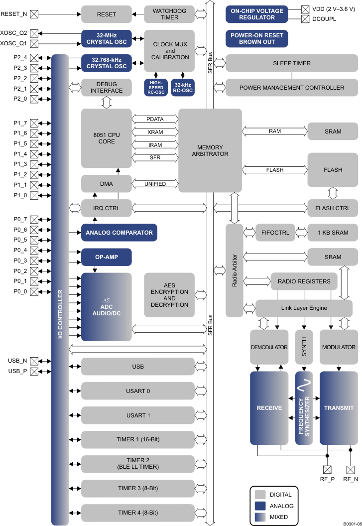

CC2540 Bluetooth low energy system-on-chip: features and benefits
  • One chip device: integrated controller, host and application in 6 mm x 6 mm package reduces physical size and cost.
  • Flash-based: device firmware can be updated in the field and data can be stored on-chip, increasing flexibility for developers.
  • Complete solution from TI: low-power RF IC, fully embedded single-mode protocol stack, profile software and applications support.
  • RF performance: excellent link budget for long range (up to +97 dB) and coexistence with other 2.4-GHz devices.
  • Interoperability/compatibility: Bluetooth specification version 4.0 compliant with single-mode (CC2540) and dual-mode devices (BlueLink 7.0 Bluetooth/FM single chip solution, WiLink 7.0 WLAN/GPS/Bluetooth/FM single chip solution, and WiLink 6.0 WLAN/Bluetooth/FM single chip solution), allowing full link testing and development.
CC2540 Block Diagram
Texas Instruments: CC2540 Block Diagram
