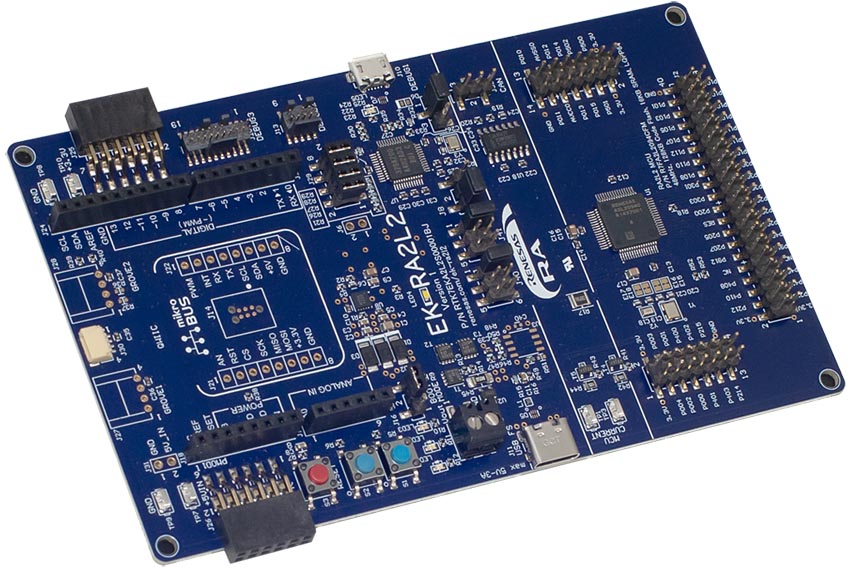

The RA2L2 MCUs are available now, along with the FSP software. Renesas is also shipping an RA2L2 Evaluation Kit.
Evaluation board for RA2L2
Evaluation board for RA2L2.
