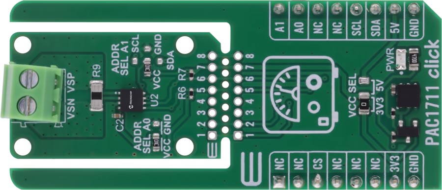

The evaluation board is a Click board compatible with the MikroElektronika's mikroBUS standard for host motherboard sockets. The Click board is used to evaluate the features and performance of the devices. Additionally, a Linux driver can be found on the product pages, providing the basic functionality and access to commonly used registers for making power measurements. Microchip also provides a generic C library for the PAC1711 and PAC1811 which includes examples of how they can be used with different MCUs from Microchip.

The PAC1711 evaluation board
The PAC1711 evaluation board.
