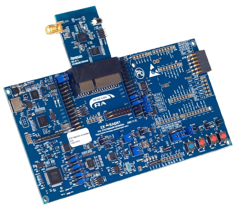

RA6W1 Evaluation Kit, consists of Motherboard and RA6W1 daughterboard
RA6W1 Evaluation Kit, consists of Motherboard and RA6W1 daughterboard.
