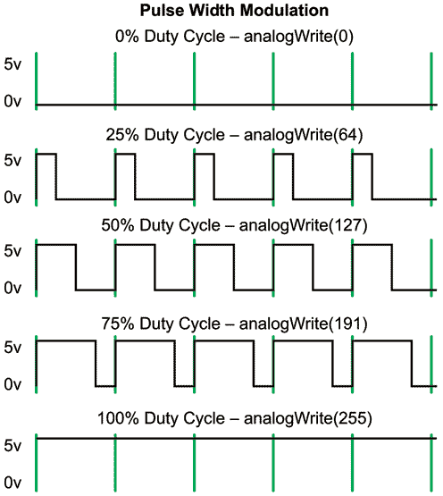

Although some AVR MCUs are equipped with digital-to-analog converters (DACs), the family members on the present generation of Arduino boards produce their analog outputs by rapidly toggling their digital I/O pins to produce pulse width modulated (PWM) signals. The duty cycle of each PWM output’s 490 Hz (approx.) square wave can be programmed to deliver an equivalent RMS voltage between 0 and 5 V in 256, 2 msec increments (Fig.1). Although somewhat limited in their capabilities, the Arduino’s outputs can be used to for many tasks such as driving LEDs or controlling motors.
Широтно-импульсная модуляция позволяет превратить цифровые линии ввода/вывода общего назначения в аналоговые выходы Arduino
Figure 1. Arduino’s digital GPIO pins can serve as analog outputs by using Pulse Width Modulation (PWM) techniques (Courtesy of Arduino.cc).
