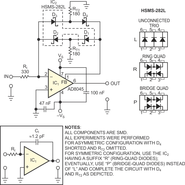

As an alternative, you can use a circuit – a fast-response voltage limiter, or clamper – as a pulse-forming circuit. The input-voltage range is narrower than that of Schmitt-trigger circuits, because, at low input voltages, the voltage limitation becomes inactive, and the circuit operates as a linear amplifier. On the other hand, because of its nonhysteretic behavior, the decision threshold of the input voltage is precise and equal for both directions of output-level transitions. Figure 1 shows one example of such as circuit. The voltage limiter in Figure 1 is an inverting amplifier with a highly nonlinear negative feedback. For output voltages ranging from –0.3 to +0.6 V, the feedback impedance is high because each of the diodes is nonconducting. The forward-voltage drop of the selected Schottky-barrier diodes determines these voltage limits. The voltage gain of the inverting amplifier is thus almost that of the op amp’s open-loop gain.
This clamping circuit uses diodes to achieve nonlinear feedback. The circuit employs a single diode in one feedback path and two diodes in the other. The dual-diode configuration offers cleaner switching.
Figure 1. This clamping circuit uses diodes to achieve nonlinear feedback. The circuit employs a single
cleaner switching.
Whenever the output voltage exceeds these limits, diode D1, D2, or D3 – depending on the polarity of the output voltage – starts to conduct. The differential gain of the amplifier then drops to the value of –RI/2RD and –RI/RD, respectively, where RD is the equivalent-series resistance of a single diode. The action clamps the output voltage to approximately 0.8 V and to –0.4 V even for large input voltages. The figure uses an Analog Devices AD8045 VHSIC (very-high-speed integrated-circuit) op amp because its slew rate exceeds the value of 1 V/nsec.
Figure 1’s circuit has an asymmetrical-limiting configuration to compare the single feedback diode with two series-connected diodes having a transverse resistor, RT1, between their midpoints and ground. The clamping circuitry comprising D1, D2, and RT1 offers higher off-isolation between the output and the input of the op amp than that of the single diode, D3. When D3 is on, you can observe small, weakly damped oscillations at approximately 200 MHz in the output waveform. Oscillations manifest themselves less at the beginning of turn-on of the D1 and D2 diodes.
