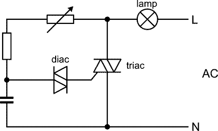

However, in many homes triac dimmers are likely to be encountered more often. Triac dimmers cause the biggest problems for LED and CFL elements that are intended to be used as retrofit light sources.
Home Lighting Controllers Offer Dimming Compatibility
Figure 2. Circuit diagram of a triac dimmer circuit.
The typical triac circuit includes a capacitor, a diac, a triac and a variable resistor that is used as the dimmer control. The capacitor is charged until the voltage reaches the breakdown voltage of the diac – the length of time this takes depends on the setting of the variable resistor. This, in turn, triggers the triac and current starts to flow across it, closing the circuit between the supply and the lamp. The current will continue to flow through the triac until it drops below the minimum hold current. As an incandescent bulb is a simple resistive load, this will occur when the mains AC input crosses the zero point. As the triac allows current flow in either direction, it will repeat the process during the negative half of the AC cycle.
