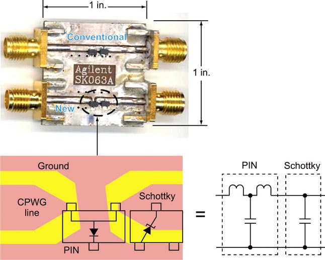

The limiter was built on a 30-mil thick FR-4 printed-circuit board (PCB) with a 50-Ω co-planar waveguide, with grounded coplanar waveguide (CPWG) transmission line having a gap in the middle (Fig. 3). The PIN diode is mounted with its anode leads straddling the gap. The Schottky diode is connected to the output side of the transmission line, as is usually done for this class of limiter. The combination of a dual-anode PIN diode, a Schottky diode, and a gapped line results in a small-signal equivalent circuit that approximates a low-pass ladder filter.
 Reduce losses in RF schottky-pin limiter circuits
Figure 3. A PCB with the evaluation and the reference limiters implements the proposed design (top). A close-up diagram (bottom left) and schematic illustration (bottom right) clarify the simplified equivalent circuit of the evaluation limiter.
For performance comparison, a conventional PIN-Schottky limiter was assembled on a continuous transmission line on the same PCB. Identical diode devices are used in both limiters. Since both diodes are paralleled in the conventional limiter configuration, its small-signal equivalent circuit can be represented by a 1.8-pF capacitor.

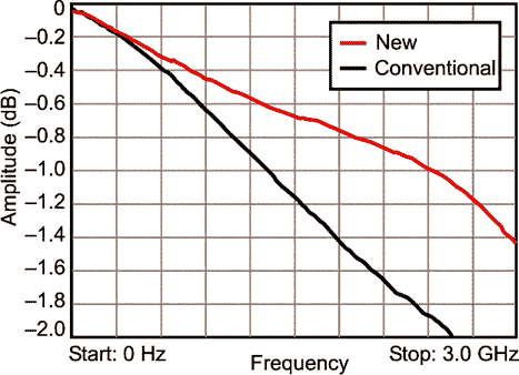

The experimental results confirm that the new configuration improves the insertion loss and the bandwidth performance. Both configurations have almost similar insertion losses below 300 MHz because the parasitic capacitances have minimal effect at these frequencies. Once the frequency increases past 300 MHz, the loss difference between limiters becomes progressively larger (Fig. 4). The measured loss reduction was an impressive 0.8 dB, measured at the popular 3G frequency of 2.1 GHz. The improvement can also be quantified as a bandwidth increase, as the new configuration nearly doubles the upper-frequency limit from the original 1.3 to 2.4 GHz when compared at the 1-dB loss points.
 Reduce losses in RF schottky-pin limiter circuits Reduce losses in RF schottky-pin limiter circuits

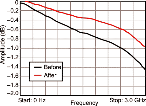

Figure 4. There is significant improvement in small-signal insertion loss versus frequency for the new limiter configuration, compared to the conventional design. Figure 5. The small-signal insertion loss of the new limiter configuration, measured before and after fixture losses compensation, clearly shows the effect of compensating for fixture losses.
Real-world results will likely be better than what these measurements suggest, because the test fixture exaggerates the loss. Actual applications are likely to have much shorter PCB traces, and the limiter output will be directly connected to the LNA without an RF connector. When fixture losses are removed by normalization, the limiter’s 1-dB bandwidth soars to 3 GHz (Fig. 5).

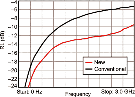

Apart from reducing insertion loss, the new configuration also unexpectedly improves the return loss (RL), particularly in the 1.2- to 3-GHz range where the change exceeds 4 dB (Fig. 6). Apparently, the new configuration’s ladder-filter equivalent circuit presents a better match than the original’s shunt capacitor. The new configuration nearly triples the upper-frequency limit to 2.9 GHz compared to the conventional configuration’s 1.1-GHz value, for the point where RL stays below –10 dB.

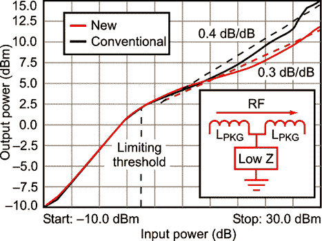

Figure 6. The return loss versus frequency of the conventional and new limiter configurations indicates improvement between 4 and 6 dB over most of the range. Figure 7. The output versus input power of the conventional and new configurations at 900.1 MHz demonstrate how the PIN diode’s package inductances aid isolation when the diode is in a low-resistance state.
The ladder network does not change the limiting threshold, but the maximum isolation is improved. Both configurations have similar ~3-dBm input-limiting threshold at 900 MHz (Fig. 7). As an unforeseen benefit, the new configuration’s output-leakage power, at 30-dBm input power, is about 4 dB lower. In the new configuration, the package inductances (LPKG) aid isolation because they are in series with the signal path, whereas they are shunting the signal path in the original configuration. The plateau region is also flatter (0.3 dB/dB) in the new configuration.

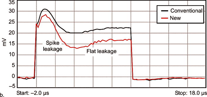

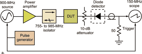

Figure 8. In the block diagram of the test setup used to evaluate the transient responses of both limiter configurations (a), note the spike-leakage and flat-leakage amplitudes are about 5 mV lower for the new configuration (b).
The ladder network does not slow the limiter’s transient response. Furthermore, it reduces the initial spike energy. The limiters’ transient response was measured using a stimulus consisting of a 10-µs burst of 30 dBm/900 MHz carrier [P(W) × t(s) = 10-6J]. The spike-leakage durations are approximately equal (~2 μs) for both configurations (Fig. 8). However, the spike energy, as represented by the area under the graph, is beneficially lower in the new configuration. Both spike-leakage and flat-leakage amplitudes are also lower in the new configuration.

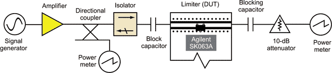

Figure 9. The test setup used for measuring the limiter's input-output power relationship must minimize measurement artefacts. The attenuator helps avoid power-sensor burnout.
Note that at the upper range of the swept-power measurement, the saturated limiter diodes approximate a short across the transmission line. The isolator and the attenuator in the test setup of Figure 9 are needed to eliminate measurement artefacts that appear as a dip in the graph of Figure 7. At the output of the device under test (DUT), a 10-dB attenuator is a better choice than an isolator because, aside from buffering the DUT's impedance change, it can prevent power sensor burn-out.
