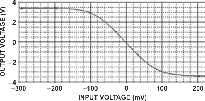

The inverting-amplifier block in Figure 1 comprises transistors Q1 and Q2, a differential pair that presents a nonlinear-transfer characteristic, plus an IVC (current-to-voltage converter) based on operational amplifier IC1. For oscillation to occur, the inverting amplifier's gain magnitude must exceed 29. Selection of appropriate values of bias current, IEE; the transistor pair's emitter-degeneration resistances, RE1 and RE2; and RE3 produces the amplifier's nonlinear-transfer characteristic, VOUT versus VIN (Figure 2).
The transfer-characteristic output voltage versus input voltage for the nonlinear amplifier shows a gradual onset of limiting at approximately 100-mV input.
Figure 2. The transfer-characteristic output voltage versus input voltage for the nonlinear
A small input voltage produces a nearly linear-amplifier-transfer characteristic. However, large values of input voltage drive Q1 and Q2 into their nonlinear region, reducing the amplifier's gain and introducing a gradual bend in the transfer characteristic. A current mirror comprising Q3 and Q4 converts the shaping circuit's output to a single-ended current, which operational amplifier IC1 converts to an output voltage. In the prototype circuit, calibration trimmer RE3 has a value of approximately 33 kΩ. Figure 3 shows the oscillator's output voltage for the component values in Figure 1, and Figure 4 shows the sinusoidal output's spectral purity.

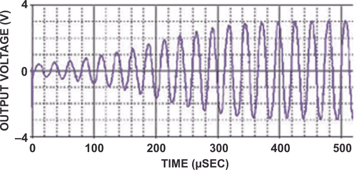

For the component values in Figure 1, the oscillator's output voltage reaches full amplitude in approximately 400 msec, or 15 cycles after start-up.
Figure 3. For the component values in Figure 1, the oscillator’s output voltage reaches full

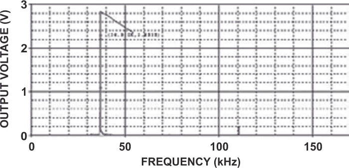

The oscillator's output spectrum shows only a slight amount of third-harmonic output.
Figure 4. The oscillator’s output spectrum shows only a slight amount of third-harmonic output.
