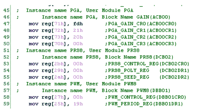

Depending upon the architecture of the programmable device, dynamic reconfiguration may be possible for many applications. However, the complexity of implementing dynamic reconfiguration may too costly if every register needs to be understood by the developer and its value set manually. To make dynamic reconfiguration practical, the development tools must provide an efficient way to set these values with minimal effort as well as provide a basic reconfiguration infrastructure for run-time implementation. Two features are essential:
  • Automatic generation of configuration register values: Development tools must provide an easy way to define and manage multiple configurations. Defining a configuration refers to the selection of the peripherals to use and their internal interconnection. Based on the configuration definition, the tool must generate the required register values for each block used in that configuration (Fig. 3). As can be seen from this code, when the development tools can generate the required register values, this frees the development from manually generating these values. This also enables developers to make frequent changes to configurations without any penalty.
  • Ease of switching configurations: If the developer has to manage switching between configurations, this will impose significant overhead as the developer creates code to read values from flash and write to the required registers, especially when frequent changes are made to configurations at the time of development. A single mistake can lead to a system malfunction that could be difficult to detect and locate. Therefore, development tools must abstract the low-level register write details and must provide a high-level application programming interface (API) to perform this task.
Dynamic Microcontroller Reconfiguration Delivers More Than 100% Resource Utilization
Figure 3. The PSoC Designer IDE generates code for configuration registers based on a user’s design.

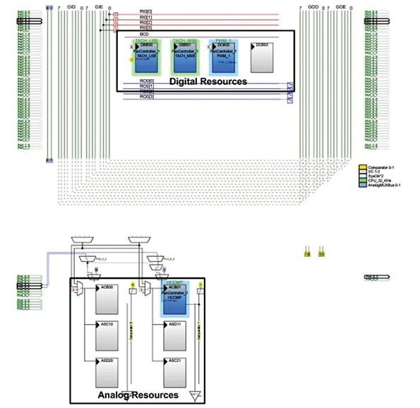

To show how dynamic reconfiguration is implemented in applications, let’s look at a real-world system. A programmable system-on-chip (PSoC) from Cypress consists of various system resources, CPU core, digital subsystem, analog subsystem, and programmable interconnects. The digital subsystem comprises various programmable digital blocks that can each be configured independently for different functions. Similarly, the analog subsystem consists of various programmable analog blocks that can be similarly configured. These subsystems are shown graphically as independent blocks in the development tool (Fig. 5).
Figure 5. The PSoC Designer Chip Editor view shows the connections to the
digital and analog resources.
To configure a programmable hardware block, developers drag a peripheral over and drop it on an empty block. It can then be connected to other peripherals or a pin. The development tool generates the required register values that are to be stored in flash at programming time. At power up or reset, before the device begins to execute the main application code, the device loads the initial configuration into the registers from flash.
Developers can define a new configuration by right clicking and then selecting a new loadable configuration in the workspace. For each configuration, developers can select different peripherals and connect them as required. Once all of the configurations are defined, the tool generates the required register values along with assembly code to move these values to their corresponding register as shown in Figure 4. Developers can also load configurations dynamically from the main application using a single line of code: “LoadConfig_[config_name]”.
