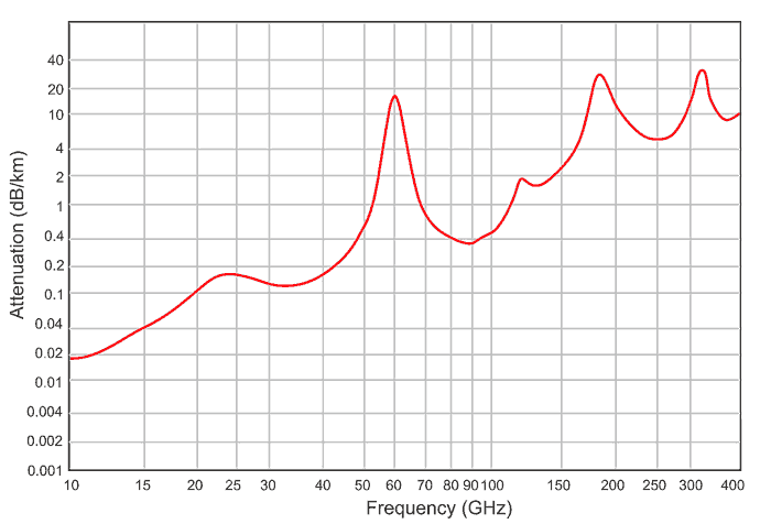

Also, the atmosphere absorbs millimeter waves, restricting their range. Rain, fog, and any moisture in the air makes signal attenuation very high, reducing transmission distances. Oxygen (O2) absorption is especially high at 60 GHz (Fig. 1). Water (H2O) absorption is responsible for the other peaks. Selecting frequencies within the curve valleys minimizes the loss. Additionally, high-gain antenna arrays can boost the effective radiated power (ERP), significantly increasing range.
 Millimeter Waves Will Expand The Wireless Future
Figure 1. The plot of signal attenuation at sea level and 20°C versus log frequency shows how oxygen (at 60 GHz) and water at the other peaks in the atmosphere significantly increase signal attenuation.
