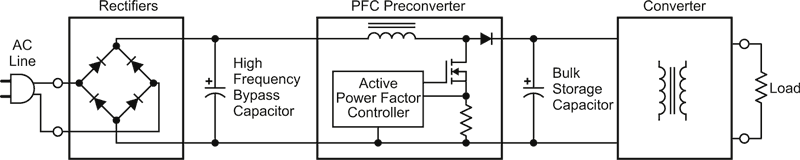

In a typical power-supply circuit, power factor correction circuitry sits between the rectifier and output storage capacitors (Figure 1). Although power factor can be corrected with passive components, active power correction offers a smaller, more effective solution for many designs.
Power Factor Correction Maximizes Power Efficiency and Quality in Energy-Harvesting Systems
Figure 1. Active power factor correction circuitry sits between rectifier
and storage-capacitor components to ensure that current
waveform shape and phase match that of the voltage
waveform (Courtesy of ON Semiconductor).

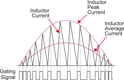

Traditional PFC circuits can be built to operate in either discontinuous or continuous mode, where the current is either switched on and off during each cycle (discontinuous), or where current never reaches zero (continuous). Critical conduction mode (CRM) is a hybrid, operating between discontinuous and continuous modes. CRM eliminates the dead time that discontinuous mode imposes between cycles until current is switched back on. At the same time, it allows the current to return to zero in contrast to continuous mode. These attributes and its relative simplicity make CRM PFC well suited to low-power applications such as energy harvesting, and designers can choose from a variety of CRM PFC ICs.
For low-power applications, designers can turn to basic CRM PFC devices including the Freescale Semiconductor FAN7527BN, Fremont Micro Devices FT821, ON Semiconductor MC33262, STMicroelectronics L6561, Texas Instruments UCC28051D, and Toshiba TB6819AFG, among others. To implement PFC, these basic devices typically rely on a gating signal to turn a power MOSFET on and off, resulting in a current waveform needed to match the voltage waveform in shape and phase (Figure 2).
Figure 2. Basic CRM PFC ICs typically provide functionality needed
to shape the current waveform by gating the inductor
current (Courtesy of Fairchild Semiconductor).
Devices in this class typically combine an error amplifier, zero current detector, switch current sensor, input voltage sensor, and switch driver, requiring only a few external components for a complete PFC solution. In addition, these devices typically include built-in circuitry for overvoltage protection, undervoltage lockout, brownout detection, and other faults.
Among differentiators, these offerings boast varying operating current levels and performance characteristics. For their L6561, STMicroelectronics included special circuitry with their linear multiplier to reduce input current distortion to deliver low THD across a wide range of load conditions. For thier FAN7527BN, Fairchild Semiconductor uses a precision two-input multiplier with tight linearity over a wide dynamic range to ensure PFC performance across a range of operating conditions.

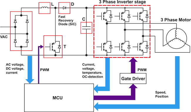

Figure 3. MCUs with integrated ADCs, DACs, and PWM functionality can
shape current waveforms in power supply stages, eliminating
the need for a separate PFC IC (Courtesy of Renesas).
Designers can also build-in basic PFC functionality with the same integrated MCU used to build the primary application. Designers can implement basic digital-based PFC controllers using integrated MCUs such as the Renesas V850E that include ADC, DAC, and PWM functionality. Here, the MCU eliminates the need for a PFC IC by controlling the gating signal needed to shape input current in a PFC stage for the primary application such as a motor controller (Figure 3).
