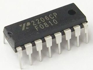

Hyperbolic tangents are vaguely related to trigonometric functions, and Alan Grebene at Exar used a single diff amp in the XR2206 function- generator (FG) IC to convert a triangle wave into a sine wave. The result was somewhat acceptable for a first-generation effort, though Gilbert carried out more refinement of the basic idea. He developed the multitanh concept of adding the outputs of diff amps that had inputs offset from each other by a fixed voltage. This approach extended the function (and input range) and also led to other novelties, including the one that is used in the AD639 sine converter.

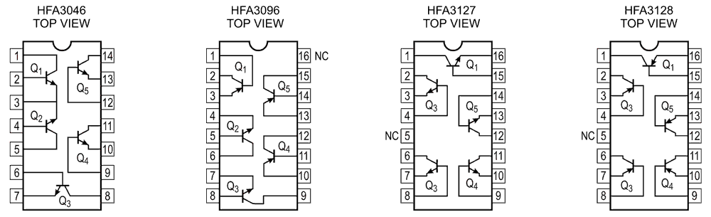

Intersil inherited a large but finite supply of these parts that is still available but dwindling. They ought to be brought back on an existing process. It is not a major development project, and such parts would be extremely useful. Intersil did create a replacement in the form of HFA3000-series SOIC parts with multiple-gigahertz fTs but with correspondingly lower breakdown voltages (Figure 2).
| Figure 2. | Replacements for the CA3000 series in the form of HFA3000-series SOIC parts offer multiple-gigahertz fTs but correspondingly lower breakdown voltages. The table shown is excerpted from Intersil parts data. |
| Table 1. Differential Pair Matching Characteristics for the HFA3046. | ||||||||||||||||||||||||||||||||||||||||||

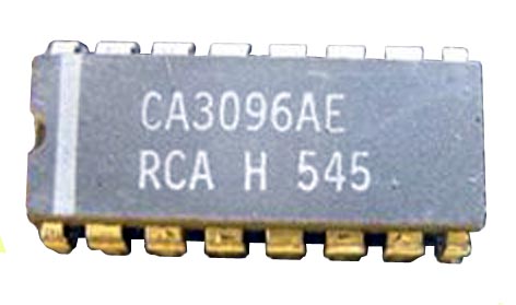

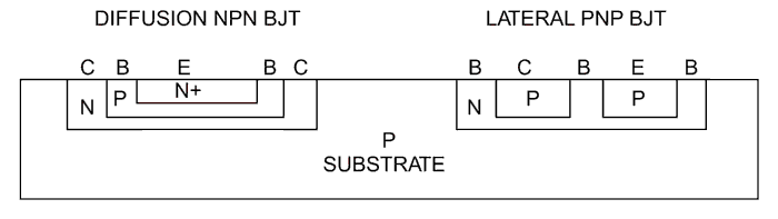

While the original CA3000 series was good for ±12 V supplies, the HFA series is better designed with ±5 V supplies, though the ICs can handle up to about 10 V. What is much improved in the HFA series are the PNP BJTs, which are dielectrically isolated rather than made as lateral transistors, as in the CA3096 (Figure 3).
| Figure 3. | The CA3096’s BJTs are constructed as lateral transistors. |

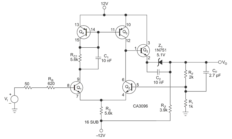

The CA3096 is a versatile part, with three NPN and two PNP BJTs. The one drawback is that the lateral PNPs have an fT of only about 6 MHz. (Making the base thin is difficult for lateral BJTs.) For numerous circuits, however, this specification is not a major impediment.
In one example, a feedback amplifier has a quasistatic gain of 3 and a bandwidth of over 50 MHz (Figure 4). It has two forward paths, the slow path through the PNP current mirror and the fast path through Q2 of the diff-amp input stage. It uses all five array BJTs. The only other semiconductor part is the avalanche diode, Z1.
| Figure 4. | This feedback amplifier has a quasistatic gain of 3 and a bandwidth of over 50 MHz. It uses all five of the CA3096’s array BJTs; the only other semiconductor part is the avalanche diode, Z1. |
You would not be inclined to design this circuit into a new product because of an uncertain component supply. In addition, the HFA part does not have the voltage range. A series comparable to the CA3000 but with dielectrically isolated PNPs would be a welcomed addition to the neo-legacy category of ICs.
