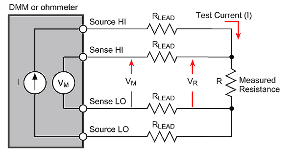

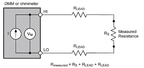

- Lead resistance. For resistance measurements, especially at lower resistances, it is important to take into account the resistance of the test leads. In the example shown in Figure 3a, the two-wire ohms method is being used to determine the resistance. A current source in the meter outputs a known and stable current, and the voltage drop is measured within the meter. This method works well if the resistance to be measured is very much greater than the lead resistance. However, what if the resistance to be measured is much closer to the lead resistance or even less? Using four-wire measurements (Figure 3b) will eliminate this problem. The voltage drop is now measured across the resistor, instead of across the resistor and leads. The input resistance of the voltmeter tends to be very high in comparison to the resistance to be measured; therefore, the lead resistances on the voltmeter path can be ignored. If, however, the resistance to be measured is very high, and approaching the resistance of the voltmeter, then an electrometer or specialized meter with extremely high input resistance may be required.

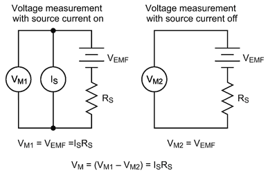

This offset-compensated ohms technique is built into many Keithley instruments. When this feature is enabled, the measurement cycle now consists of two parts (Figure 4): the first part is measuring the voltage with stimulus current switched on, the second part is to measure it with the stimulus current switched off. Subtracting the latter from the former will subtract out the errors due to thermoelectric EMFs. Therefore, this technique will effectively eliminate accuracy issues due to temperature drift.

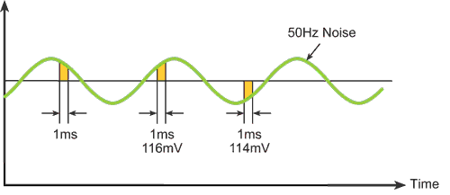

- External interference. External interference introduces both AC and DC errors into signal measurements. The most common form of external noise «pick-up» is 50 Hz or 60 Hz line pick-up, depending on where in the world the measurements are being made. Picking up millivolts of noise is not uncommon, especially when measurements are made near fluorescent lights. The signal components of noise superimposed on a DC signal being measured may result in highly inaccurate and fluctuating measurements. As shown in Figure 5, the measured value will very much depend on where the measurement is carried out in relation to the sine wave. Many modern instruments allow users to set the integration period in relation to the number of power line cycles. In other words, a setting of 1 NPLC will result in the measurement being integrated for 20 milliseconds (if 50 Hz) and 16.67milliseconds (if 60 Hz), which will eliminate any mains generated noise. The performance improvements this feature make possible are often dramatic.

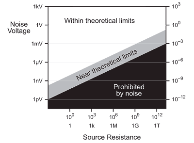

- Theoretical measurement limits. The laws of physics provide a fundamental limit of how low a signal can be resolved because every system will generate some level of voltage and current noise. Figure 6 identifies the levels of voltage that are impossible to measure, as well as the levels approaching the theoretical limits of voltage measurement.
