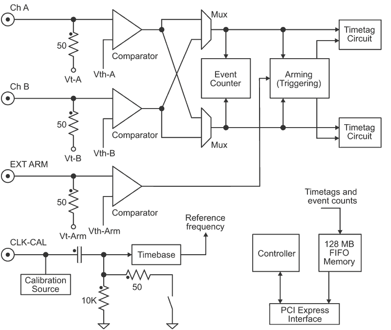

How does it work?
The simplified block diagram in Figure 2 shows the key components of the instruments from the user’s point of view. The input signal is terminated by 50 ohms to a user-programmable voltage (Vt) and fed to a comparator. The comparator output goes high when the signal crosses a user-programmable threshold voltage (Vth). At this point the signal is a digital waveform whose rising or falling edges are considered to be “events”. These events are continuously counted by the Event Counter, while the Arming System selects the edges which are to be timetagged according to the user configuration. For example, you can set up the instruments to timetag every N events, or every T seconds.
Time Interval Analyzers
Figure 2. BI200 simplified block diagram.
When an event is timetagged, the event count (pulse number) and the time of the occurrence are logged to memory. The Timetag Circuits require a recovery time of 250 ns to be ready for another timetag. Note, however, that the signal is still counted by the Event Counter, so no information is lost. This recovery time means that up to 4 million timetags (or pairs of timetags) can be logged per second. From this timetag data, the instruments calculate the measurement results Figure 3.
