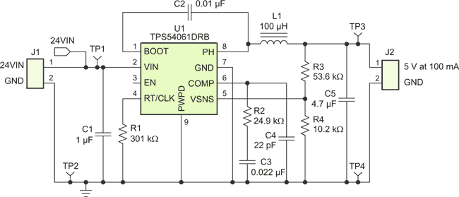

The design in Figure 1 uses a synchronous buck converter with integrated MOSFETs, the TPS54061 from Texas Instruments (TI). Note that this circuit does not require a catch diode but includes an inductor, five capacitors, and four resistors. The device also employs external compensation and is tuned to use the same input and output capacitors as the linear circuits in Figures 2 and 3.

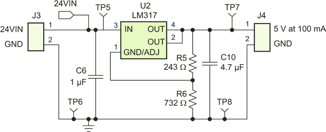

The design in Figure 2 uses an integrated, wide-input-voltage linear regulator, TI’s LM317, which is a popular, industry-standard regulator with a 1.5-A output capability. This circuit uses two external resistors and two external capacitors. The wide difference between the input and output voltages requires the low thermal resistance of a double-decawatt package (DDPak).

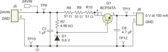

Figure 3 shows a discrete linear regulator that employs a transistor and a Zener diode with two external capacitors and four external resistors. The Zener diode breaks down at 5.6 V, and that voltage is fed to the base of an NPN transistor. Due to the base-emitter voltage drop, the output is regulated to ~5 V. The external resistors are used to help with the power dissipation in the NPN transistor.

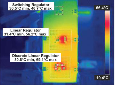

The thermal image in Figure 4 shows the temperature rise of each design on the circuit board. The board is designed in a manner such that none of the circuits disturb the thermal performance of an adjacent circuit. Table 2 shows that the switching regulator has the lowest temperature rise, at 11 °C. With a large difference between the input and output voltages, the switching regulator with synchronous rectification excels in efficiency compared to either linear circuit. (See Table 3.) It is interesting to note that the temperature rise of the integrated linear circuit is different from that of the discrete linear circuit. Since the integrated linear regulator’s package (DDPak) is larger, its dissipated heat is spread over more area. The discrete linear circuit using the SOT-23 and SOT223 packages is smaller than the DDPak and has a higher package power dissipation rating, which makes dissipating the heat more difficult.

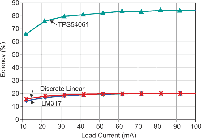

Efficiency comparison
 Linear versus switching regulators in industrial applications with a 24-V bus
Figure 5. Efficiency versus load current.

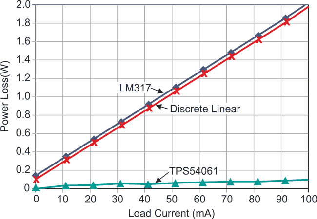

The thermal performance is directly related to the efficiency of each regulator. Figure 5 shows an efficiency comparison of all three circuits. As expected, the switching regulator excels at both light-load and full-load efficiency. At light loads, switching losses and quiescent-current losses become more pronounced, which explains the reduced efficiency at lighter loads. At light loads, it is better to view the powerloss graph (Figure 6) than the efficiency graph, since a 50% difference in efficiency at 10 mA seems like a large margin. However, the amount of current consumed by the load is small. When the input voltage is 24 V and the output current is 10 mA, the power loss of the switching regulator is 2.8 mW, and the loss of the integrated linear regulator is 345 mW. At full load, the measured power dissipated is 0.093 W for the switching regulator versus 2.06 W for the linear regulator, which shows a wide margin and a drastic improvement.
Figure 6. Power loss versus load current.
Table 3 summarizes the efficiency and power loss of all three circuits. Note that the quiescent current of the discrete linear circuit is lower than that of the integrated linear circuit.

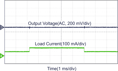

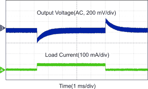

Analog circuits may be sensitive to voltage ripple, and digital processors may be sensitive to the accuracy of the core voltage. It is important to check the power supply’s voltage ripple, voltage-regulation accuracy, and voltage-peak deviations during load transients. Linear regulators inherently have low ripple and are used to remove noise from switching regulators. The voltage ripple of both the integrated and the discrete linear-regulator circuits under maximum load is under 10 mV. When expressed as a percentage of the output voltage, accuracy is better than 0.2%. On the other hand, the voltage ripple of the switching regulator is 75 mV, or 1.5% of the output voltage. The low equivalent series resistance of the switching regulator’s ceramic output capacitor allows for the circuit’s low ripple, despite the switching regulator’s inherent noise.
Figure 7. Switching regulator during load transient.
Comparing the output-voltage accuracy of the switching and linear regulators from no load to full load shows that the switching regulator has better performance. Further inspection of the product specification tables reveals that the reference voltage of the switching regulator is the most accurate of the three circuits. The switching regulator is a relatively new integrated circuit, and DC/DC converters are trending towards higher reference-voltage accuracies. The discrete linear circuit, which uses a simpler method for regulating the output voltage, has the worst performance. In many cases, applications do not need high voltage accuracy since the 5-V output may be postregulated.
Figure 8. Integrated linear regulator during load transient.

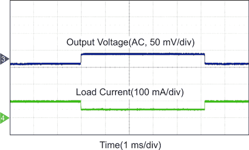

The load-transient plots can be seen in Figures 7 through 9. Although the switching regulator has high output-voltage accuracy, its measured peak-to-peak voltage during a load transient is not as competitive as that of the linear circuits. The switching regulator’s measured peak-to-peak voltage during a 50- to 100-mA load step is 250 mV, or 5% of the output voltage, compared to 40 mV for the linear circuits. Additional output capacitance can be added to the switching regulator to reduce the voltage peaks, but with penalties in cost and size. Note that the discrete linear circuit is not designed to attempt recovery of the output voltage during a load transient. Also, the simplicity of the circuit does not allow for current limiting or thermal shutdown protection!
Figure 9. Discrete linear regulator during load transient.
Table 4 summarizes the output-voltage characteristics of the three regulator designs.
