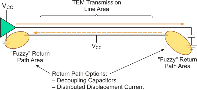

For example, let's take a microstrip trace over a metal plane, but let's have a PCB stack up where the metal plane is assigned as 3.3 V (not "ground"). A ground plane will exist lower in the PCB stack. The schematic will indicate the return current path is ground, not 3.3 V. Unfortunately, the current does not read the schematic to see where the designer intended the current to flow. It will follow the path of least impedance. At frequencies higher than about 1 MHz, this means the path of least inductance. That path will nearly always have the smallest current loop size, so the current will flow on the 3.3 V plane, not the ground plane.
The image below shows the electric field lines for a microstrip. Where those field lines terminate, current will flow (into or out of the page). Even though the signal on the trace was driven relative to a ground plane (which is not shown) below the VCC plane, the field lines terminate on the VCC plane. The return current will always flow in the nearest plane, regardless of its schematic name.

How does the return current get on a conductor that is not called for in the schematic? After all, we solder the ground pin on the IC to the ground plane, not the VCC plane. The image below shows that, even though the current driven down the signal trace goes into the capacitive load of the CMOS IC at the load end and to the ground pin, it migrates to the VCC conductor once the return current gets a little distance from the IC.
The myth called
Zero-to-one transition current path for CMOS devices.
The actual migration path (or fuzzy return path) depends on the location of decoupling capacitors, the displacement current through the PCB dielectric, etc. The exact path will differ for each case, and it would require full wave analysis to predict the path accurately.
I am fond of saying ground is a place for potatoes and carrots. When working with moderate- or high-speed PCBs, the concept of ground is unimportant. The return current path is the most important issue. Engineers always take great care to make sure the intentional signal path is connected as desired, but they seldom consider the return current path. Interruptions in the return current path are the most common cause of PCB-related EMC issues, both for immunity and for emissions. Many signal integrity issues can also be traced to poorly designed return current paths.
