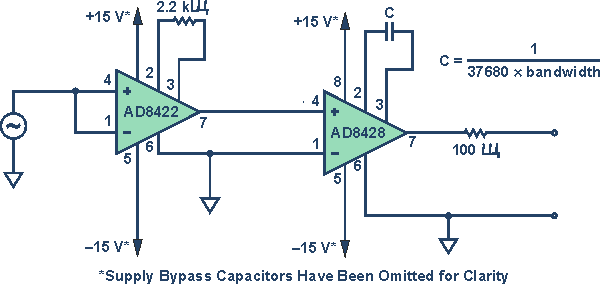

For example, a popular CMRR test for instrumentation amplifiers consists of measuring the output while applying the same signal to both inputs. An example test circuit for the AD8422B (configured for gain of 10 V/V) is shown in Figure 1. The second amplifier, an AD8428, works in a gain of 2000 to amplify the small error generated by the device under test to make it easier to measure with standard lab equipment, like a scope.
O CMRR, CMRR! Wherefore Art Thou CMRR?
Figure 1. CMRR test circuit.
With this setup, it is possible to observe an output change of 40 mV for a 2 V common-mode change at the input, which is equivalent to 20 µV at the output of AD8422B. This is not bad at all, but one might argue that 10 µV/V corresponds to 100 dB of rejection, while the data sheet guarantees a CMRR of at least 114 dB! Have we found a defective part? Where did the CMRR go?

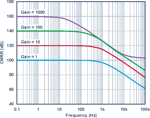

Figure 2. AD8422 CMRR vs. frequency.
Note that not all in-amps have their CMRR increase with gain, and some even start to taper off with larger gains. In other words, an in-amp with CMRR of 120 dB may only go to 130 dB when the gain increases by 20 dB. We call this effect CMRR compression. Yet, we have seen the AD8422 increase its CMRR to 160 dB with no compression (Figure 2). Now that, folks, is a CMRR performance that's really hard to find.

Please note that noise and high gain (20,000) makes this measurement challenging. For this reason, it is necessary to filter the source to minimize its noise contribution. AD8428 uses a capacitor between its filter terminals to reduce the measurement bandwidth. Moreover, proper shielding and wiring is required to avoid external noise pickup.
