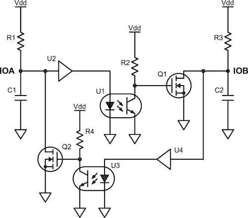

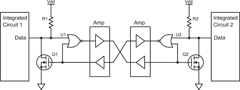

The I2C bus specification [1] contains a reference circuit which allows it to be split into input and output pairs. This configuration is needed for several reasons. First, the split-bus can be used to optically isolate the bus master and slaves in cases of safety, noise, and grounding issues (Figure 1). Additionally, performance gains can be realized by amplifying the split-bus (Figure 2) or replacing the amplifier with a circuit that performs media conversion. This can increase the operating distance of the bus and increase performance by reducing capacitance. As capacitance goes down, the signal time constants, τ, become dominated by the pullup resistors.
| Figure 1. | Bidirectional bus isolation. |

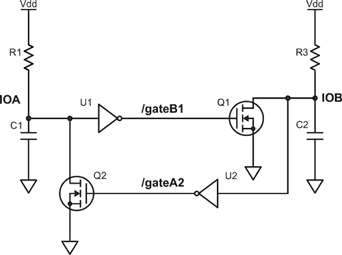

For those designing bidirectional bus controllers, the bus splitting technique can be used for debug. Typical debug of bidirectional protocols is made difficult because a misbehaving controller may pull the bus to 0 while another controller is asserting control of the bus. This situation makes identification of the transmitting device on the bus impossible without knowledge of the internal states of each device’s controller. However, monitoring the /gateB1 and /gateA2 lines from Figure 2 enables the identification of both the transmitting devices and any simultaneous assertions of the bus using only standard lab equipment and debug techniques.
| Figure 2. | Bidirectional bus repeater. |

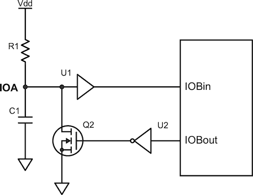

Lastly, the bus splitting technique can be used to connect an I2C supported device to another device that does not have an I2C controller. In this case, the split bus can be connected to the GPIOs of the other device (Figure 3).
| Figure 3. | Split bus interfaced to GPIOs. |

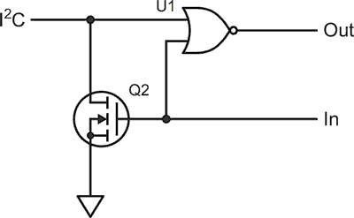

There are several published circuits which enable splitting of a bidirectional bus. Unfortunately, the reference circuits for split-bus applications either require specially designed circuits for a particular application (as seen in published articles), or require external control logic (as seen in the I2C standard) that uses transmission gates to allow the sender and receiver to communicate without creating a feedback path that causes latchup. The latchup condition is evident in Figure 2, where IOA pulling the bus to 0 forces IOB to pull to 0 through /gateB1, which then forces IOA to get pulled to 0 indefinitely through /gateA2.
| Figure 4. | Bilateral arbiter enabling circuitry. |

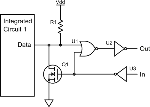

The bilateral arbiter presented in this Design Idea can split a bidirectional bus into transmit and receive pairs, and is constructed in a generic way that allows it to be used for any split-bus application. Additionally, it requires no external control logic – the bus is controlled solely by the state of the data bus (Figure 4).

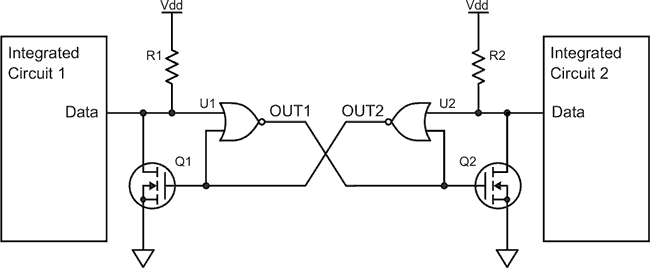

Bilateral Arbitration
| Figure 5. | Bilateral arbitration of a bidirectional bus. |
The arbiter shown in Figure 5, comprised of cross-coupled enabling circuits from Figure 4, works because bidirectional buses, by definition, only support half-duplex communications. In a steady state, the DATA bus is pulled high by pullup resistors R1 and R2, which forces OUT1 and OUT2 to 0. This keeps both NMOS FETs in the cutoff state. When IC1 pulls DATA low, OUT1 goes to 1, which makes Q2 pull down the DATA bus of IC2. Simultaneously, OUT1 is fed to an input of NOR gate U2, breaking the feedback loop from OUT2 back to Q1. This breaking of the feedback loop removes the latchup condition, making any other control logic unnecessary, since the first circuit to assert its data line wins the race and blocks the other circuit via the NOR gate.
| Figure 6. | Bilateral arbitration enabling bus amplification. |
Due to the generic nature of the circuit, bilateral arbitration can be applied to any split-bus application. Figure 6 shows bilateral arbitration applied to amplification. This can easily be extended to media conversion and bus isolation, by replacing the amplifier component with either a media conversion circuit or an optoisolator, respectively. For bus controller debug purposes, the lines in between the amplifiers can be monitored to help identify malfunctioning bus controllers. Figure 7 shows bilateral arbitration being applied to an I2C-to-GPIO connection.
| Figure 7. | I2C to GPIO connection. |
