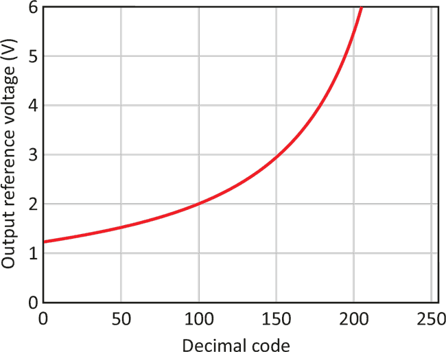

A limitation of using a digital potentiometer in this application is the voltage limit of the digital potentiometer IC, which typically cannot exceed 5.5 V. Therefore, it's important to confirm that the resistance ratio does not get set to a condition that would present a VREF_OUT greater than 5.5 V. For a 256-tap digital potentiometer and a shunt reference with an internal reference of 1.24 V, the decimal code should not exceed 200. Figure 4 demonstrates the effect of the input code on the reference voltage for a 256-tap potentiometer and a 1.24-V-referenced device.
| Figure 4. | The relationship between digital code and reference voltage is not linear, but can easily be calculated as needed, or determined in advance and stored. |
