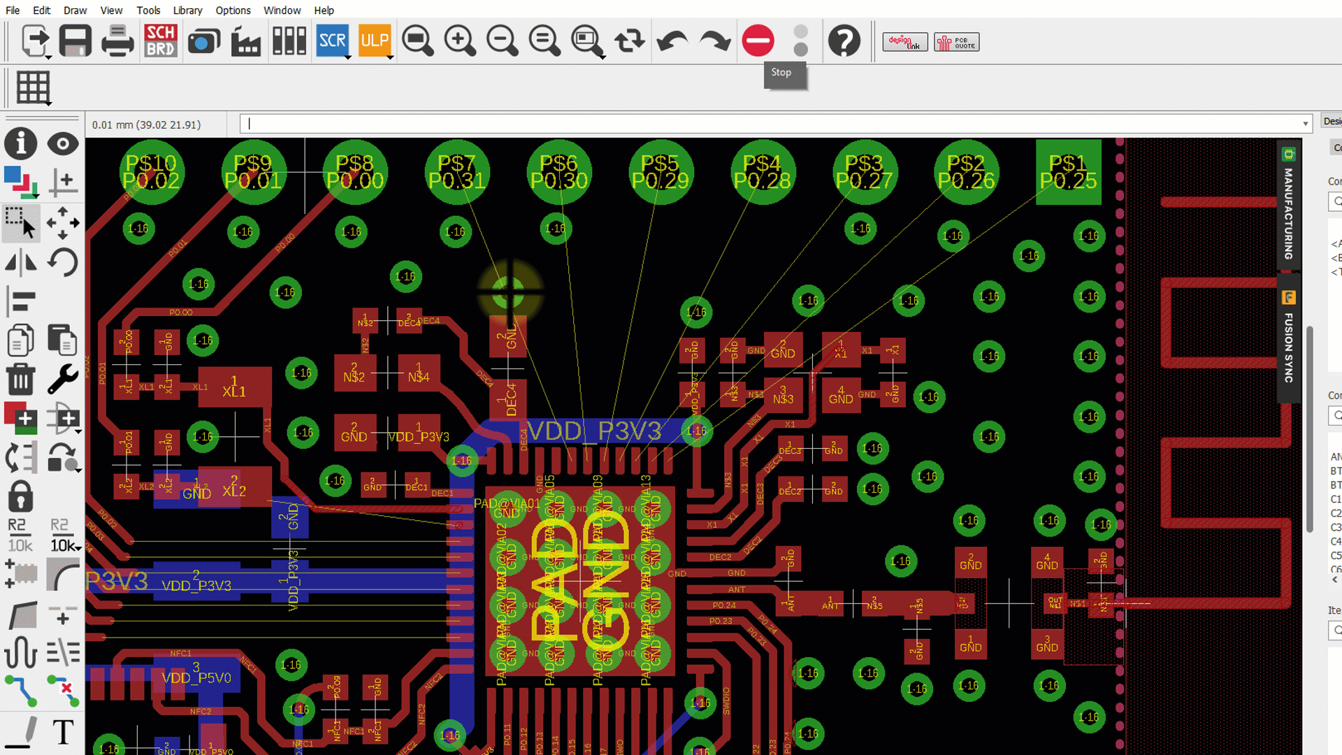

What it does
Quick Route lets you route single nets, multiple nets and differential pairs in rapid-fire with a single mouse click. No, this is not another autorouter, this is an intelligent routing aide. You get to decide which nets get routed, and Quick Route does the manual busywork of connecting that net from node to node for you.
With Quick Route we’ve designed a system that analyzes all of your nets holistically before deciding how to make a connection. How does this manifest? When Quick Route connects a net, the results look incredibly natural and human. You get the beauty of a flowing board layout without all of the manual busywork.
Today, Quick Route supports single-click finish for:
  • Airwires
  • Single or multiple nets
  • Differential pairs
  • Trace smoothing
How it works
Enter routing mode and you’ll discover four new Quick Route options to work with:
  • Quick Route Airwire
This mode completes airwire connections instantly in a single click for individual signals or differential pairs. There are two methods for using this mode. You can either click the beginning of an airwire connection and have it auto complete. Or you can start routing an airwire manually, and press Enter on your keyboard at any time to have Quick Route take over and complete the connection (Figure 2).

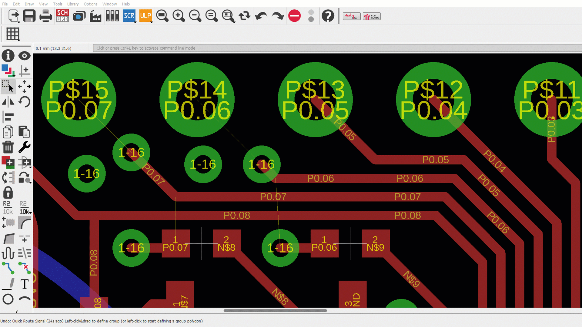

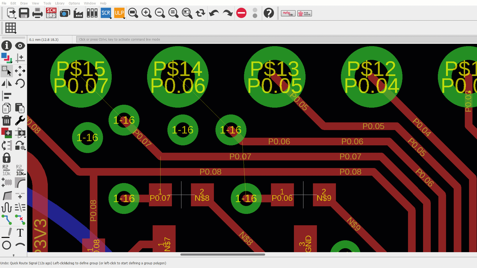

  • Quick Route Signal
Similar to Airwire, Quick Route Signal will complete an entire net connection in a single click for either individual nets or differential pairs. Again you can either let Quick Route take care of the job completely, or start routing your net and press Enter to complete the connection (Figure 3).
Quick Route Signal completes will complete an entire net connection.
Figure 3. Quick Route Signal completes will complete an entire net connection.

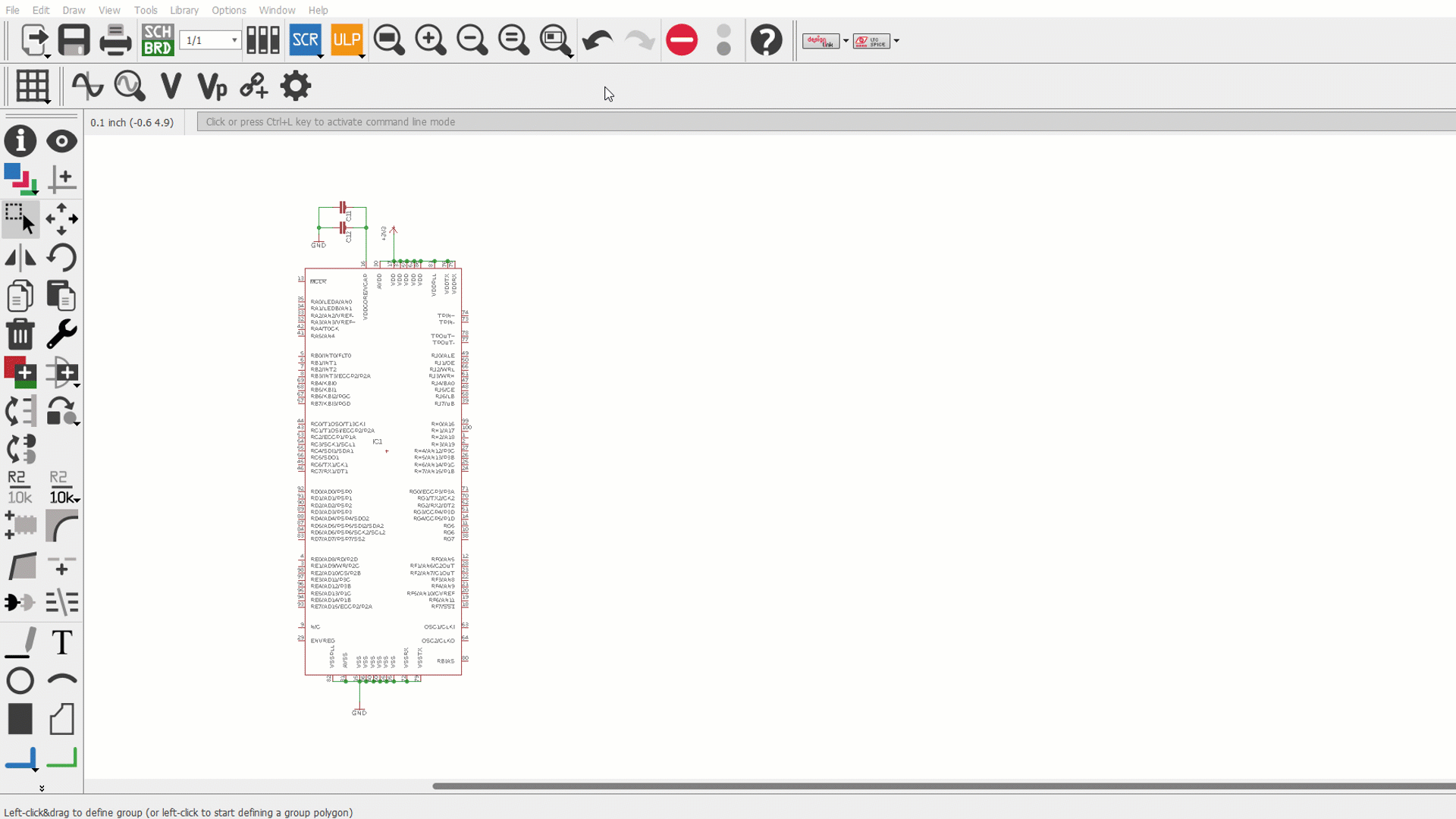

Quick Connect
We’re all familiar with the challenging process of designing a schematic. The hardest part isn’t finding the parts or placing them. It’s spending an insane amount of time wiring every pin and making labels.
Take something like a 2K pin BGA (Figure 6). Breaking out all the pins and adding labels can literally take an entire workday. And what happens if you make a typo on a label or connect one of those pins incorrectly? This kind of work, while it’s something we’ve all accepted as part of the job, just isn’t worth our time. With Quick Connect, we’ve done away with the manual and error prone process of wiring schematic symbols and creating net labels.
BGAThis one might take a while.
Figure 6. This one might take a while.
What it does
Place a symbol or bus down on a schematic and Quick Connect will automatically break out every pin and its label. This feature is priceless when working with high pin-count components. We’ve all spenta colossal amount of time breaking out BGAs or ICs, only to find out we made a simple mistake on a label or connection. These are all mistakes of the past.

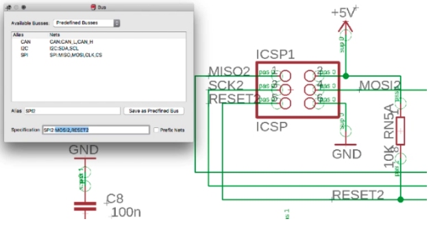

How it works

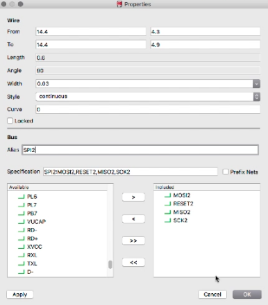

EAGLE now has the ability to save buses for future reuse. By default there’s CAN, I2C, and SPI buses created out of the box. Need to create a new one? Select all of your desired signals, create a bus, and the signals get automatically added for you (Figure 7).
Eagle 9.0 now has the ability to save buses for future reuse.
Figure 7. Eagle 9.0 now has the ability to save buses for future reuse.
If you’re just wiring a bus without configuring it beforehand, all of the required signals can be added in the Bus Properties dialog. Give that bus a name and you have yourself a saved bus (Figure 8).
Figure 8. Required signals can be added in the Bus Properties dialog,
then give that bus a name and you have yourself a saved bus.

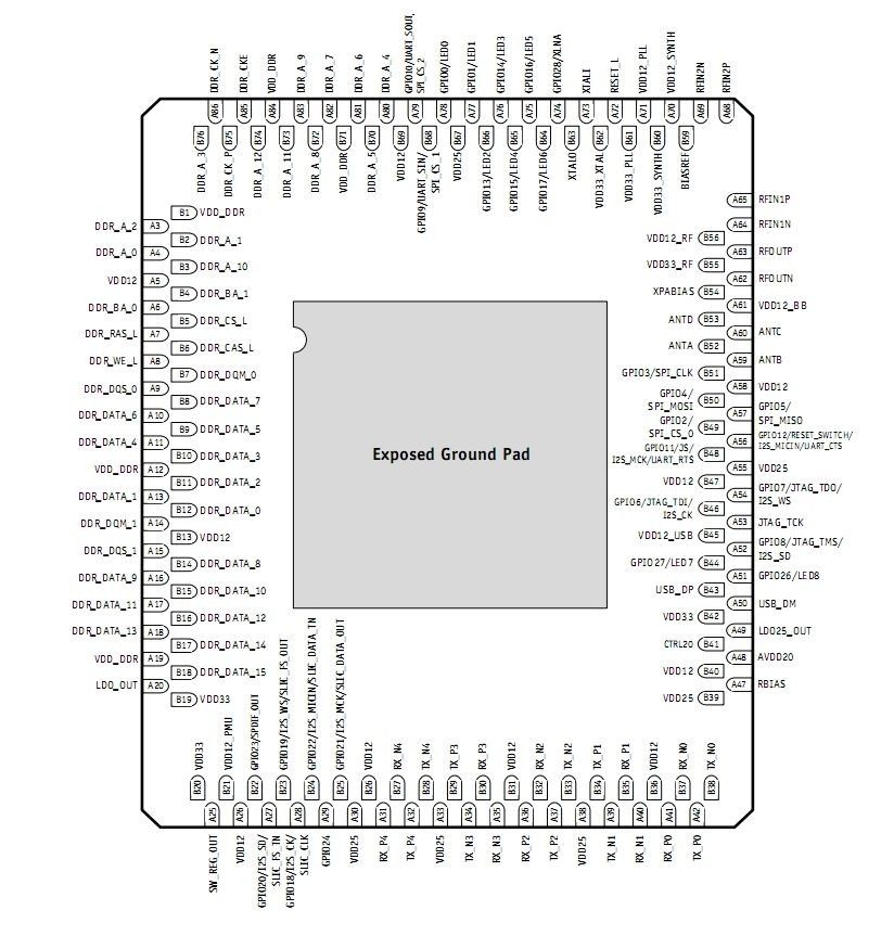

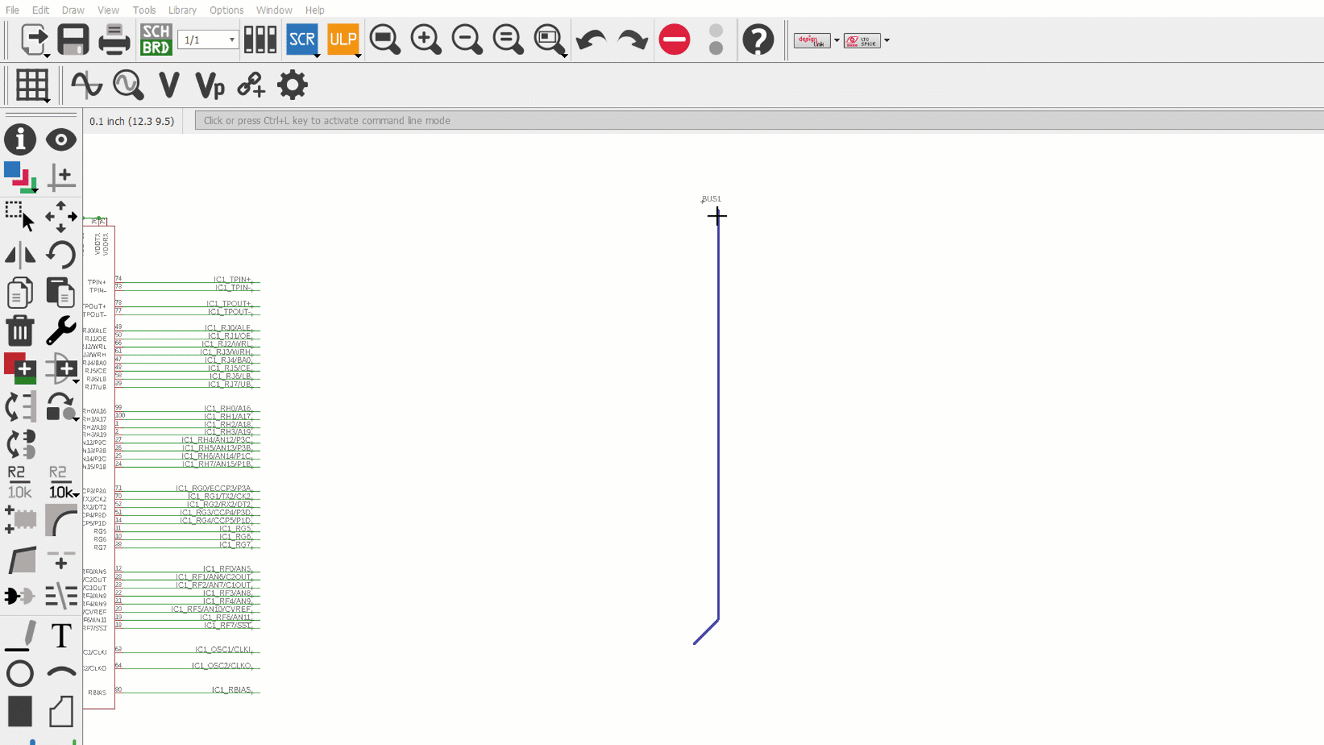

Signal Breakout
Let’s throw something more challenging at Quick Connect, like a 30+ pin integrated circuit. Imagine having to break out every pin and add labels manually on a symbol like this. That’s going to take you at least 30 minutes at a minimum.
Right click to use the new Breakout Pins feature, and watch what happens, instantly (Figure 10):
Eagle 9.0 Signal Breakout function.
Figure 10. Eagle 9.0 Signal Breakout function.

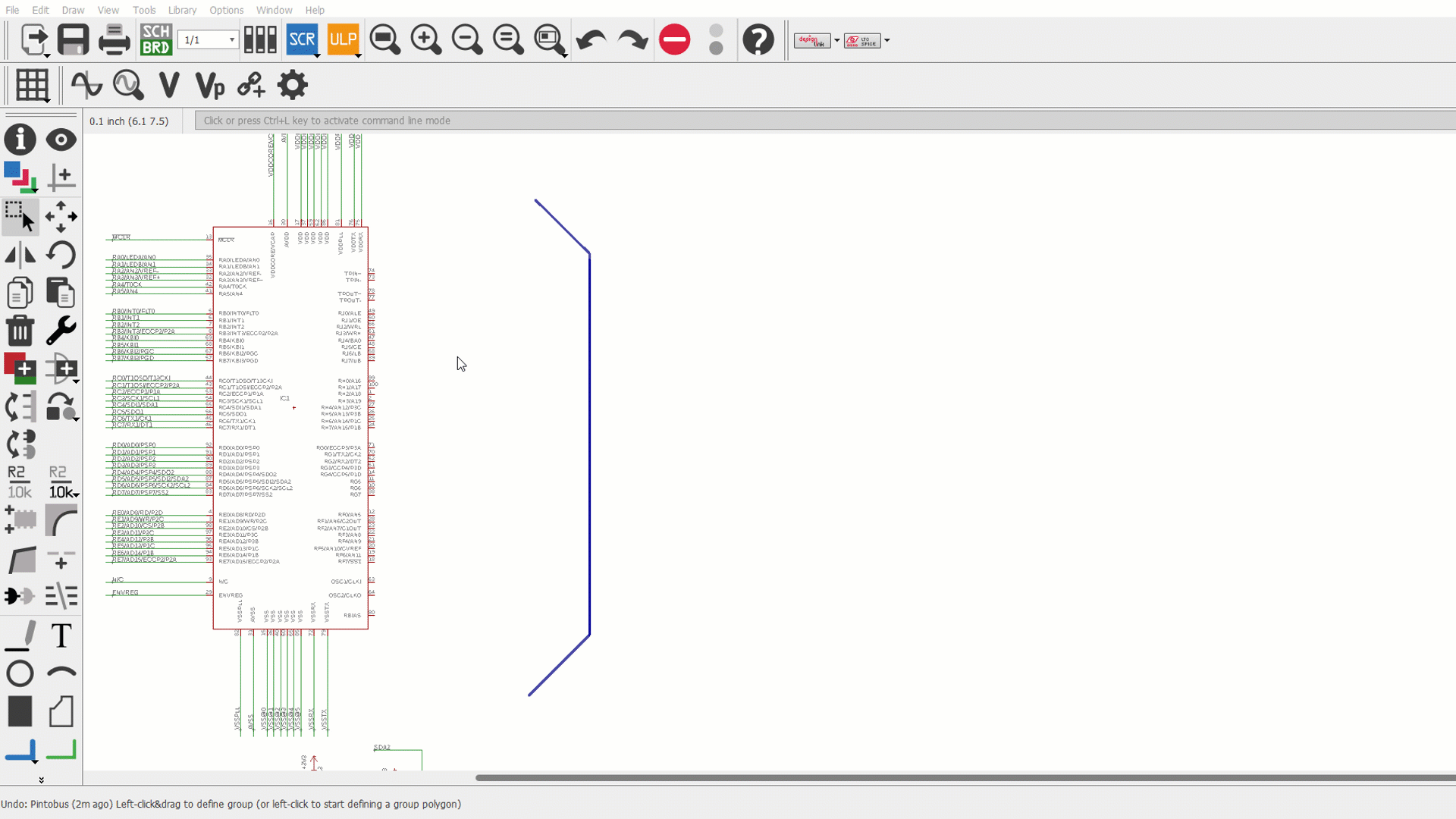

Connect Pins to Bus
How about connecting all of the pins from your IC to a bus? Another manual process that takes way too much time. With a preconfigured bus filled with signal names that match our IC, we can make this process happen instantly (Figure 11):
Connect Pins to Bus with Quick Connect function in Eagle 9.0.
Figure 11. Connect Pins to Bus with Quick Connect function in Eagle 9.0.

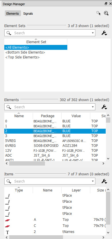

When you open EAGLE 9 for the first time you’ll notice the Design Manager nestled on the right side of your interface. If this placement isn’t to your liking, no worries, you can dock the panel to the left side of the UI, float it around, or get rid of it entirely. Happen to close it accidentally? Open it again from View > Design Manager.
The Design Manager has two primary views to work from, Components and Nets. For the component view, there are a few standard component groups that help to quickly filter parts by the top and bottom side of your board. You can also search for parts manually. Once a component is selected in the Design Manager, it gets highlighted on your board (Figure 13).
Eagle 9.0: Once a component is selected in the Design Manager, it gets highlighted on your board
Figure 13. Once a component is selected in the Design Manager, it gets highlighted
on your board.
A selected component will also be broken down into its individual elements in the Design Manager. This gives you greater visibility over individual silkscreen and pad features without having to open the library editor (Figure 14).

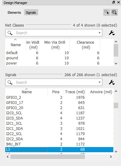

The real power of the Design Manager comes when working with nets. You can either search for nets in the search bar, or filter by your preconfigured net classes (Figure 15).
In Design Manager you can either search for nets in the search bar, or filter by your preconfigured net classes.
Figure 15. In Design Manager you can either search for nets
net classes.
