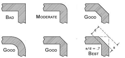

8) The proper corner drawings are shown below;
9) T shaped nodes should be like shown in the figure;

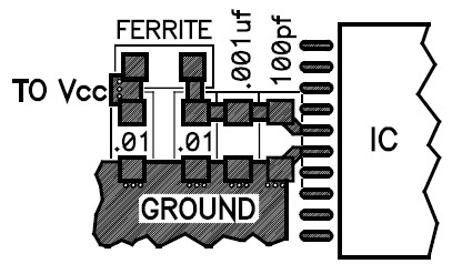

10) Decouple the supply voltage. An example circuit and its PCB is shown below. Consider that the capacitor with a smaller capacitance is placed nearer to the IC.
