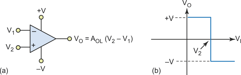

One way to look at the operation of a comparator is to examine the basic op-amp configuration shown in Figure 1a. The amplifier has very high open-loop gain (AOL >> 1000). What it amplifies is the difference between the two inputs V1 and V2. The output is:
Because of the high gain, it doesn’t take much of a differential input signal (V2 – V1) to drive the output to either the positive or negative power rail. For example, if the supplies are ±5 V, and the open-loop gain is 100,000, a differential input of 5/100,000 = 50 µV or more will drive the output to the rail. Figure 1b depicts the input-output transfer curve.
Beyond the Op Amp - Designing With IC Comparators
Figure 1. Here’s an op amp connected as an inverter (a), and its
input-output transfer curve (b).

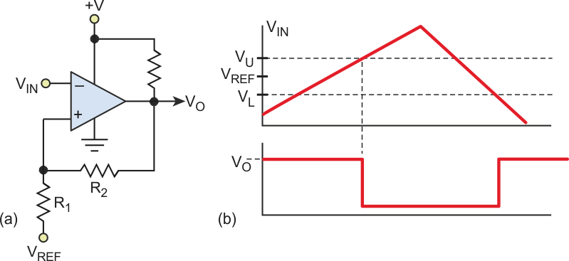

Dealing with Noise
One problem that often occurs is the noise or multiple short transitions on the output at the threshold points. This so-called chatter occurs when the input is varying slowly and can cause false triggering in an application. Even with very clean input voltages, comparators have their own noise – like an op amp. They also sometimes make noise when the output slams from one rail to another, reverberating through the supply or output circuitry back to the input.
One way to overcome this is to use hysteresis [2] (Fig. 3). The reference is applied via two resistors that provide regenerative or positive feedback that speeds up the switching and virtually eliminates the chatter.
A comparator with hysteresis (a) can eliminate chatter at the transition points (b)
Figure 3. A comparator with hysteresis (a) can eliminate chatter
at the transition points (b).
What the hysteresis does is to establish upper (VU) and lower (VL) trip point voltages around the reference level. The small window or dead zone keeps the output clean with no chatter. The values of R1 and R2 set the trip points that can be calculated with these equations:
