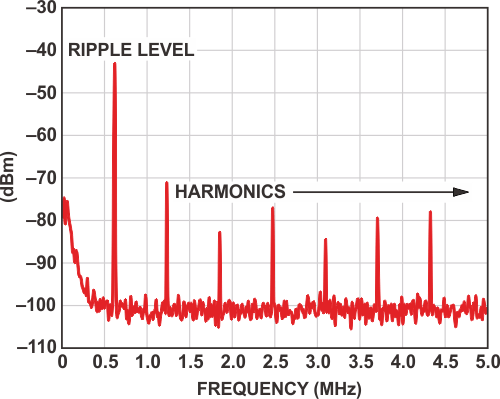

Frequency Domain Measurement
When measuring unwanted output signal artifacts, it is useful for power engineers to think of the frequency domain, as this provides a better perspective as to which discrete frequencies the output ripple and its harmonics occupy with each corresponding power level. Figure 2 shows an example spectrum. This type of information helps engineers to determine whether the chosen switching regulator is appropriate for their wideband RF or high-speed converter applications.

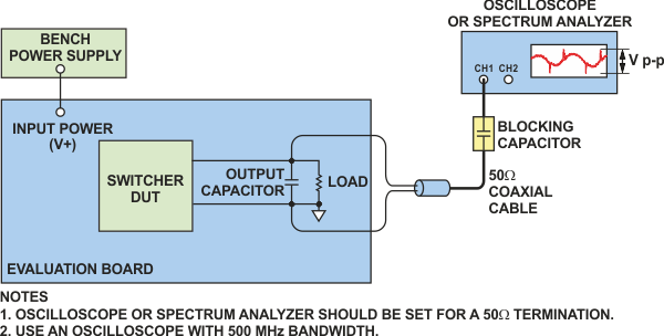

To make a frequency domain measurement, connect a 50-Ω coaxial cable probe across the output capacitor. The signal goes through a dc-blocking capacitor and ends with a 50-Ω termination at the input of the spectrum analyzer. The dc-blocking capacitor prevents dc from passing to the spectrum analyzer and avoids dc-loading effects. The 50-Ω transmission environment minimizes high-frequency reflections and standing waves.
The output capacitor is the main source of output ripple, so the measurement point should be as close as possible. The loop from signal tip to ground should be kept as small as possible to minimize additional inductance that may affect the measurement. Figure 2 shows output ripple and harmonics in the frequency domain. The ADP2114 generates 4-mV p-p output ripple at the fundamental frequency under the specified operating conditions.

The best method for probing the switcher’s output uses a 50-Ω coaxial cable maintained in a 50-Ω environment and terminated by the oscilloscope’s selectable 50-Ω input impedance. A capacitor placed between the regulator’s output capacitor and the oscilloscope’s input blocks dc flow. The other end of the cable can be soldered directly to the output capacitor using very short flying leads, as shown in Figure 9 and Figure 10. This preserves signal integrity when measuring very low-level signals over a wide bandwidth. Figure 11 shows a comparison of the tip-and-barrel method and the 50-Ω coaxial method probed on the output capacitor using a 500-MHz measurement bandwidth.
