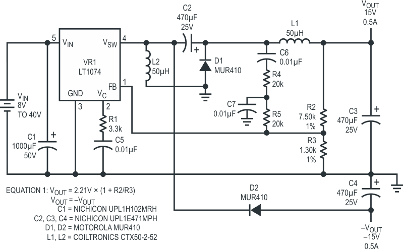

Many systems derive ±15 V supplies for analog circuitry from an input voltage that may be above or below the 15 V output. The split supply requirement is usually fulfilled by a switcher with a multiple-secondary transformer or by multiple switchers. An alternative approach, shown in Figure 1, uses an LT1074 switching regulator IC, two inductors and a “flying” capacitor to generate a dual-output supply that accepts a wide range of input voltages. This solution is particularly noteworthy because it uses only one switching regulator IC and does not require a transformer. Inductors are preferred over transformers because they are readily available and more economical.
Schematic diagram for ±15 V version.
Figure 1. Schematic diagram for ±15 V version.

The output voltage is controlled by the LT1074 internal error amplifier. This error amplifier compares a fraction of the output voltage, via the R2 to R3 divider network shown in Figure 1, with an internal 2.21 V reference voltage and then varies the duty cycle until the two values are equal. The RC network (R1 and C5 in Figure 1) connected to the VC pin along with the R4/R5 and C6/C7 network provides sufficient compensation to stabilize the control loop. Equation 1 can be used to determine the output voltage.
