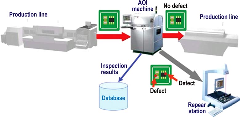

Step 4. Pre-Reflow Automated Optical Inspection (AOI):
It is very vital to take inspection after finishing component placement because whether components connect correctly or not will influence the whole function of the PCB. The best way of doing this is by using an AOI machine to make checks such as component presence, type/value and polarity.

Step 6. Post-Reflow Automated Optical Inspection (AOI):
The last part of the surface mount assembly process is to again check that no mistakes have been made by using an AOI machine to check solder joint quality. Sometimes, the movement during the reflow process will result in poor connection quality or a complete lack of a connection, in other words, shorts are also a common side effect of this movement, as misplaced components can sometimes connect portions of the circuit that should not connect. Thus, the inspection after reflow soldering is quite important and checking for these errors and misalignments can involve one of several different inspection methods. The most common of these inspection methods include the following:
  • Manual Checks
  • Automatic Optical Inspection (AOI)
  • Automated X-ray inspection (AXI)
