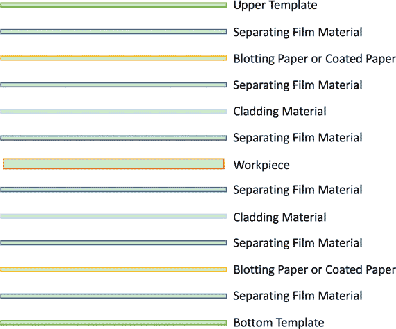

7. Lamination
7.1 Lamination of Cladding Layer of Flex-PCB
According to different flexible substrates to determine the lamination time, heating rate and pressure and other laminating process parameters. Generally speaking, its process parameters are as follows:
Simple Analysis of Flex-PCB Manufacturing Process in PCBWay
  • Lamination time: the net pressure time under the full pressure is 60 min.
  • Heating rate: temperature need to reach 173 °C within 10 to 20 min from the indoor temperature.
  • Pressure: 150-300 N/cm2, to reach the full pressure within 5-8 seconds.
7.2 Gasket Material of Lamination:
The choice of gasket material is very important to the lamination quality of flexible and rigid-flex PCB. The ideal gasket material should have good formability, low fluidity, and cooling process does not shrink, in order to ensure that no bubbles and flexible material laminate in lamination, deformation does not occur. Gasket materials are usually divided into flexible and rigid systems. Flexible system mainly includes PVC film or radiation polyethylene film and other thermoplastic materials. The rigid system is mainly made of glass cloth reinforced by silicone rubber.
