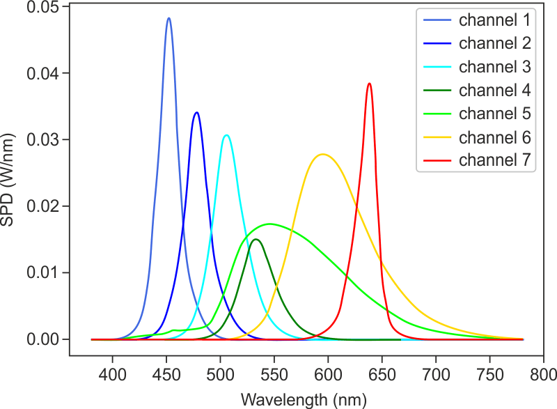

For example, Ledmotive's HCL system (Figure 2) includes an LED module that uses seven independent color channels to reproduce any spectral configuration, statically or dynamically, with essentially no UV or IR emissions (Figure 3). The modules, incorporated into luminaires, are then connected via a bus to a hub for communication with a lighting network controller or building management system.
Spectral power distribution of seven independent channels of the Vega 07 module. (Source: Ledmotive).
Figure 3. Spectral power distribution of seven independent channels of the Vega 07
