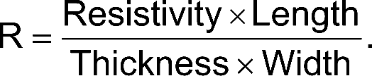

The copper traces used in PCB layout have some resistance. This resistance is not constant but depends on the length, thickness and width of the copper trace. Whenever current passes through a trace, it will experience a voltage drop, power dissipations and a rise in temperature. Resistance is defined by:
In order to control the resistance, focus on the size of the trace i.e. its length, thickness and width etc. We measure PCB trace thickness in ounces of copper. One ounce of copper is means 1 oz. of copper over an area of 1 square foot area. This thickness is equal to 1.4 thousandths of an inch. Usually 1-2 oz. copper is used but 6 oz. is also available. You can use a PCB trace width calculator to calculate the width and thickness of your traces with respect to its application. Try to keep a 5 °C temperature rise. If you have extra space then use larger traces in your layout. Also keep in mind that the inner layers will heat up more than the outer layers.

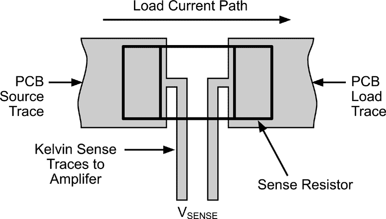

Correct Kelvin Connections
Kelvin connections are used to make electric potential contact with a current carrying component that reduces or eliminates the effect of contact resistance. Kelvin connections are useful in measurements and are made in a way to reduce stray resistances and inductance. If you don’t use Kelvin connections then the traces on the schematic placing could put your measurements off due to inductance and resistance.

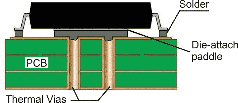

Using Thermal Vias
Using thermal vias will help in heat dissipation. You should try to use larger vias to transfer more heat and try to increase efficiency by lowering the operating temperature. A lower operating temperature will consequently increase the reliability.

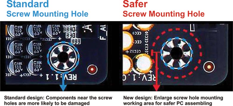

Distancing between Traces and Mounting Holes
You can reduce the effects of shock hazard by leaving space between the copper traces and mounting holes. Also make sure there is space between copper and any mounting components.
