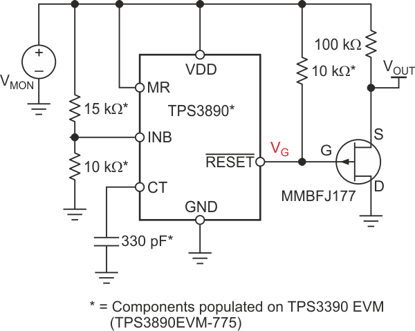

Add a P-type JFET to remove false low-voltage output signals
Most supervisors require a certain amount of voltage on VDD before the device’s output can give an accurate output. This voltage is typically around 800 mV – below this voltage, the supervisor has no way to control the internal circuitry that’s pulling the output low or high. As a result, the output will rise up with the pull-up voltage until there is enough headroom for the device to pull it back down. Many times you can ignore this; however, in the cases where you cannot, you can add a P-channel junction field effect transistor (JFET ) to ensure that the output stays low even when VDD is not sufficient to provide power to the supervisor. Figure 4 shows an example.
Adding a JFET to remove output voltage rise with low VDD.
Figure 4. Adding a JFET to remove output voltage rise with low VDD.

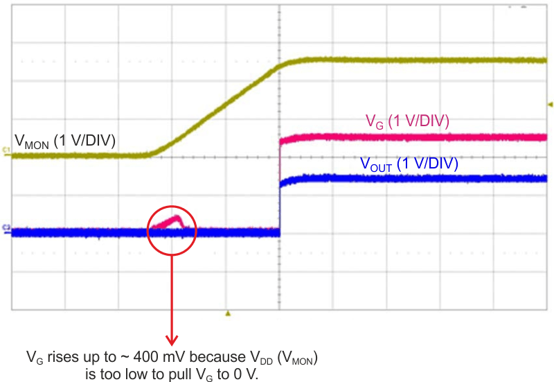

In Figure 4, the normal output of the TPS3890 is represented as VG. When VMON (the monitored voltage) rises, the voltage at VG also rises briefly, to around 0.5 V. By adding a standard JFET configured in a source-follower configuration, the voltage at the source (labeled as VOUT) will track the voltage at VG minus the threshold voltage of the JFET. This results in an approximate 1 V drop between VG and VOUT, and eliminates the 0.5 V rise on VG. Figure 5 shows the effect of using a JFET on the output of the TPS3890.
TPS3890 startup with and without a JFET on the output.
Figure 5. TPS3890 startup with and without a JFET on the output.
