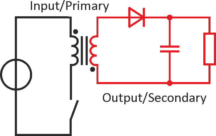

In the basic flyback cycle, closing the primary-side switch increases the primary current and magnetic flux in the transformer/inductor as the primary-side circuit is supplied by the source (Fig. 1). The voltage in the secondary-side winding is negative due to the relative relationship between primary and secondary windings. Therefore, the diode is reverse-biased and blocks current flow and the secondary-side capacitor supplies the current to the load during operating phase.
In the first cycle of flyback-converter operation, the primary-side switch is closed, thus increasing the primary current and transformer/inductor magnetic flux. (Source: Wikipedia)
Figure 1. In the first cycle of flyback-converter operation, the primary-side

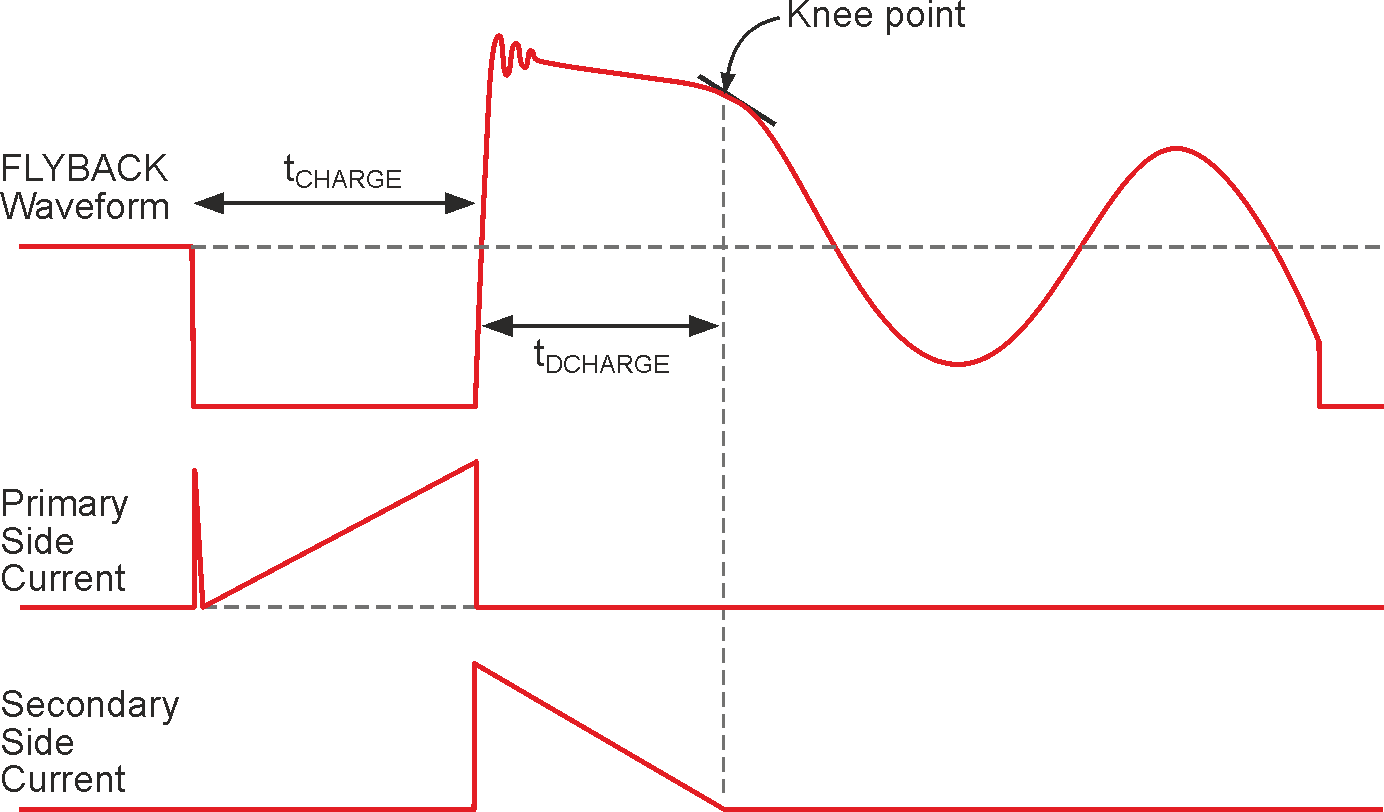

In a flyback design, the output capacitor is similar to a bucket that’s either being filled (recharged) or emptied (supplying the load), but it never undergoes both at the same time. The resultant output ripple must be filtered by the capacitor, which is never allowed to drain down to zero charge. The “flyback” name is due to the sudden stop/stop, on/off action of the MOSFET switch, with a waveform that looks like a sudden reversal of current flow (Fig. 3).
The basic waveshape of the flyback topology shows the sudden reversal and transitions for primary and secondary-side currents. (Source: Wikipedia)
Figure 3. The basic waveshape of the flyback topology shows the sudden reversal and transitions for

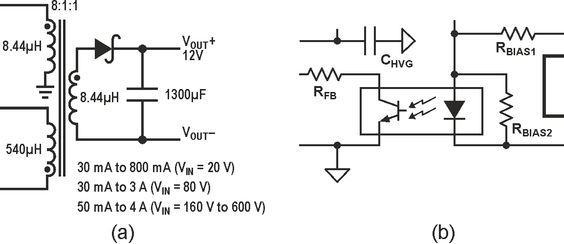

Regulation of the output is achieved by adjusting the on/off duty cycle of the primary-side switch. Some designs also adjust frequency of the switching action (faster switching results in closer tracking of the output to the desired output value. This feedback with required input-output isolation is provided either via a special winding on the transformer (the traditional and historical approach) (Fig. 4a) or via an optocoupler (Fig. 4b).
The traditional flyback design uses a transformer/inductor with at least two primary windings and one secondary winding (a). Some flyback designs use an optocoupler to provide the isolated feedback equivalent to the second primary-side winding (b). (Sources: Analog Devices and Texas Instruments)
Figure 4. The traditional flyback design uses a transformer/inductor with at least two primary windings and
