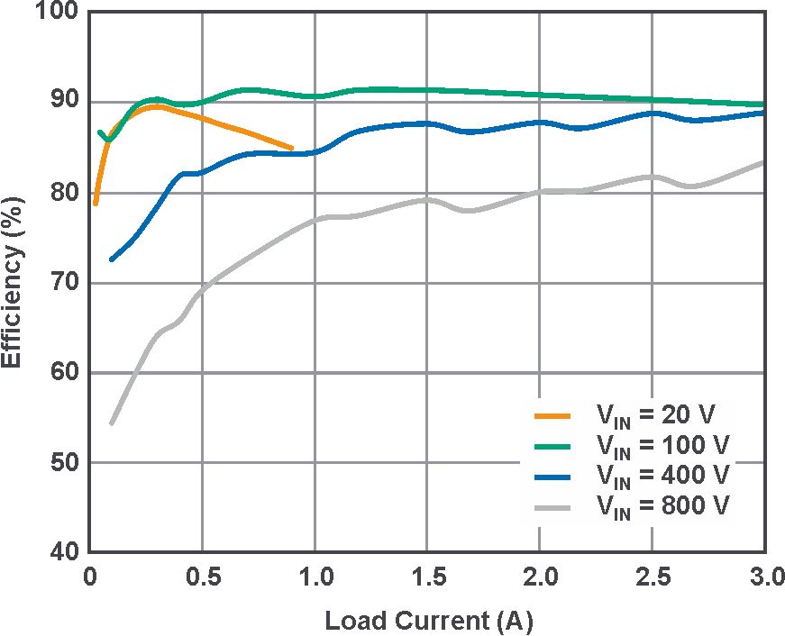

Efficiency of the flyback converter in Figure 1.
Figure 2. Efficiency of the flyback converter in Figure 1.

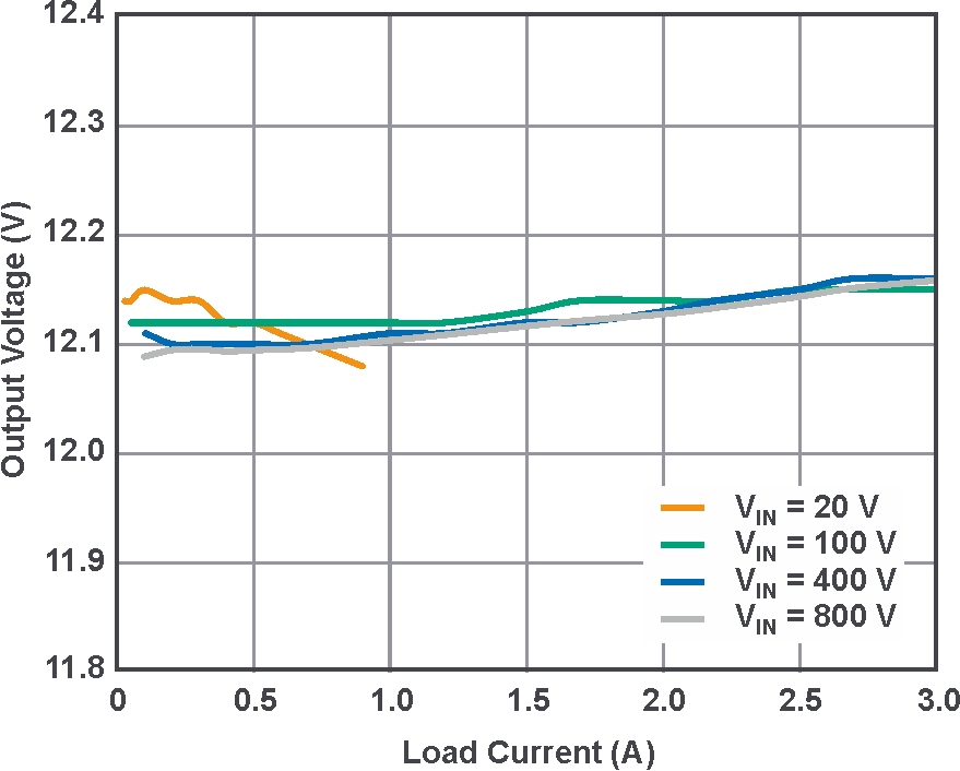

Figure 2 shows efficiency at various input voltages, with the flyback converter achieving 91% peak efficiency. Even with no optocoupler, load regulation at different input voltages remains tight, as shown in Figure 3.
Load and line regulation of the flyback converter in Figure 1.
Figure 3. Load and line regulation of the flyback converter in Figure 1.

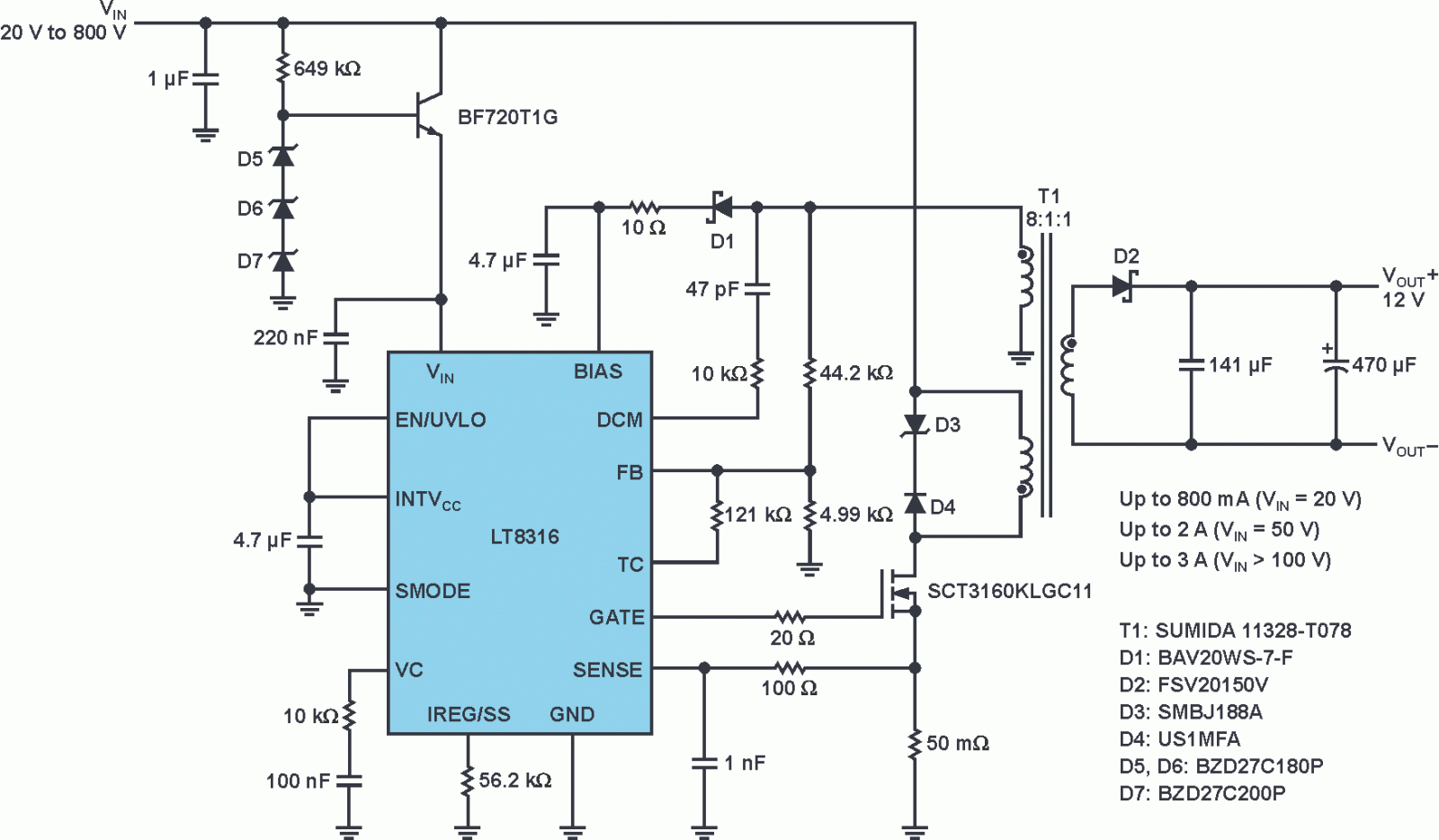

Low Start-Up Voltage Design

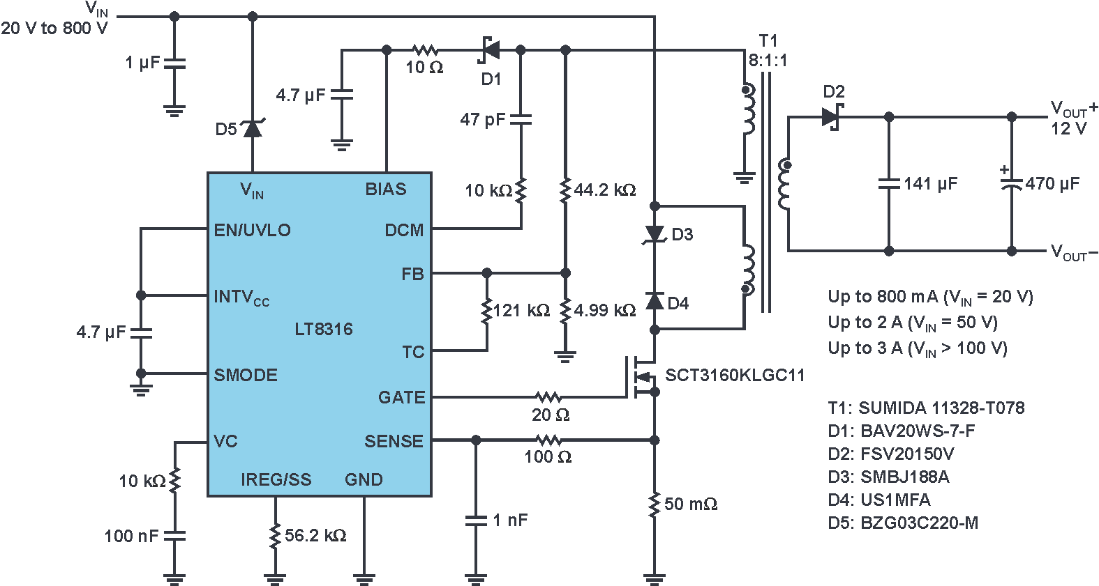

The previous solution extends the input voltage to 800 V, but the Zener diode raises the minimum start-up voltage to 260 V. The challenge is that some applications require both high input voltage and low start-up voltage.
An alternative 800 V maximum input voltage solution is shown in Figure 4. This circuit uses Zener diodes and a transistor to form a voltage regulator. The input voltage can safely go to 800 V with the VIN pin regulated at around 560 V. The benefit of this circuit is that it allows the LT8316 to start up at a lower supply voltage.
Schematic of an isolated flyback converter: 20 V to 800 V input to 12 V, with low start-up voltage.
Figure 4. Schematic of an isolated flyback converter: 20 V to 800 V input to 12 V, with low start-up voltage.

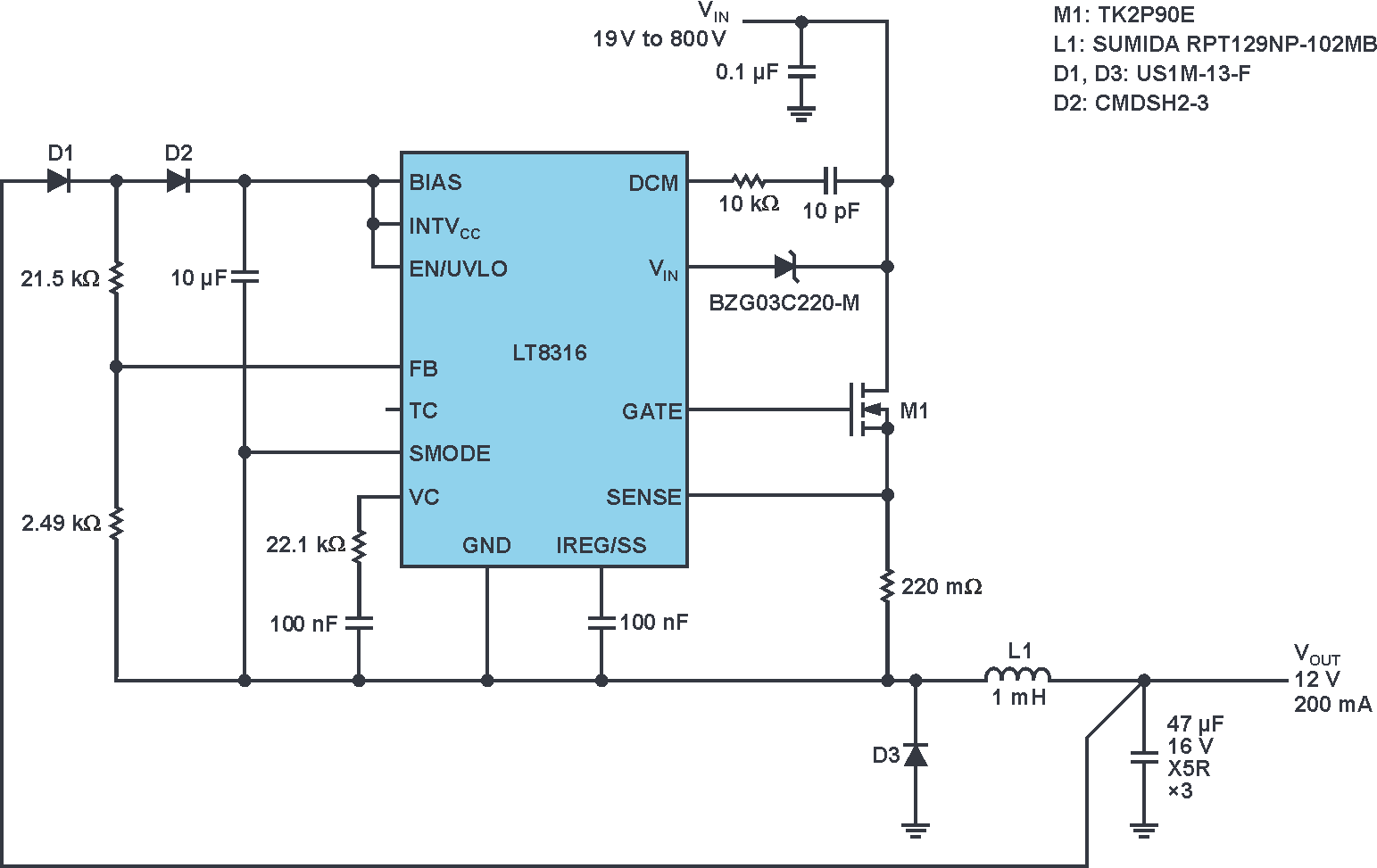

The LT8316’s high voltage input capability is easily applied in a simple, nonisolated buck converter where an isolated transformer is not required. A relatively inexpensive off-the-shelf inductor is adopted as the magnetic component.
Schematic of a nonisolated buck converter with up to 800 V supply voltage.
Figure 5. Schematic of a nonisolated buck converter with up to 800 V supply voltage.
For a nonisolated buck application, the LT8316’s ground pin is connected to the switch node of the buck topology, which is a varying voltage. The unique sensing scheme of LT8316 sees the output voltage only when the switch node is connected to the ground, which leads to a simple buck schematic.

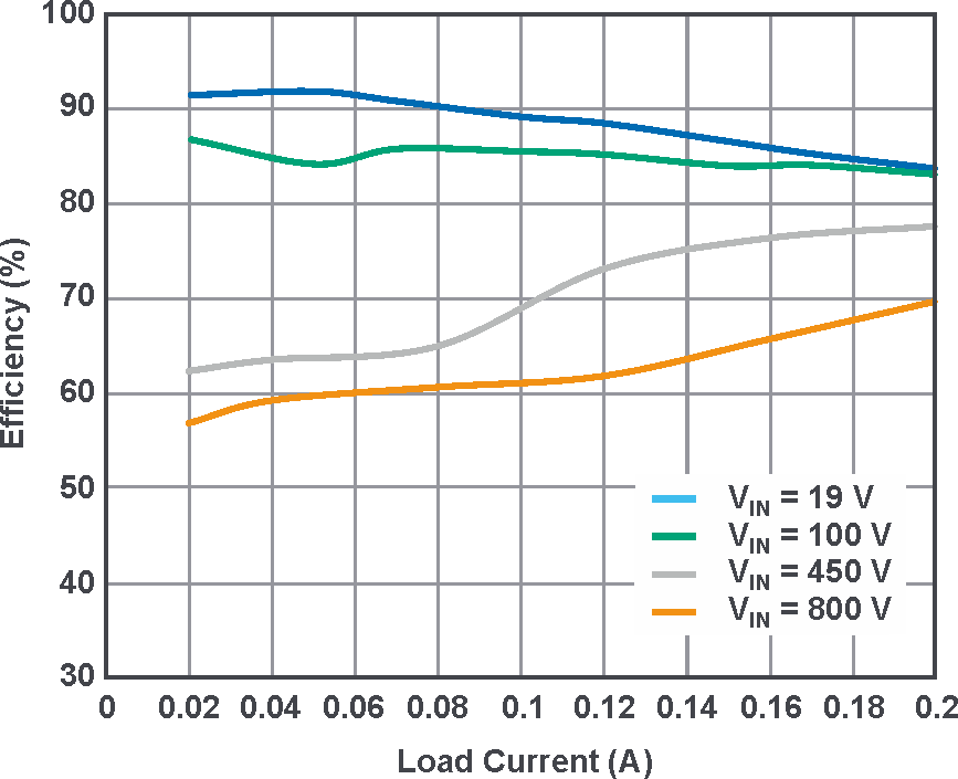

Efficiency of the buck converter in Figure 5.
Figure 6. Efficiency of the buck converter in Figure 5.

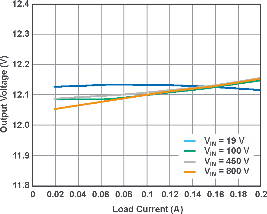

As with the flyback converter, the supply voltage of the buck converter can be extended. Figure 5 shows the schematic of a buck converter with up to 800 V input voltage. A 220 V Zener diode is placed between the supply voltage and VIN pin of LT8316. The minimum supply voltage for startup is 260 V, considering the voltage tolerance of the Zener diode. After startup, the LT8316 continues to operate normally with lower supply voltage. Figure 6 shows efficiency at various input voltages, with the buck converter achieving 91% peak efficiency. The load and line regulation is shown in Figure 7.
Load and line regulation of the buck converter in Figure 5.
Figure 7. Load and line regulation of the buck converter in Figure 5.

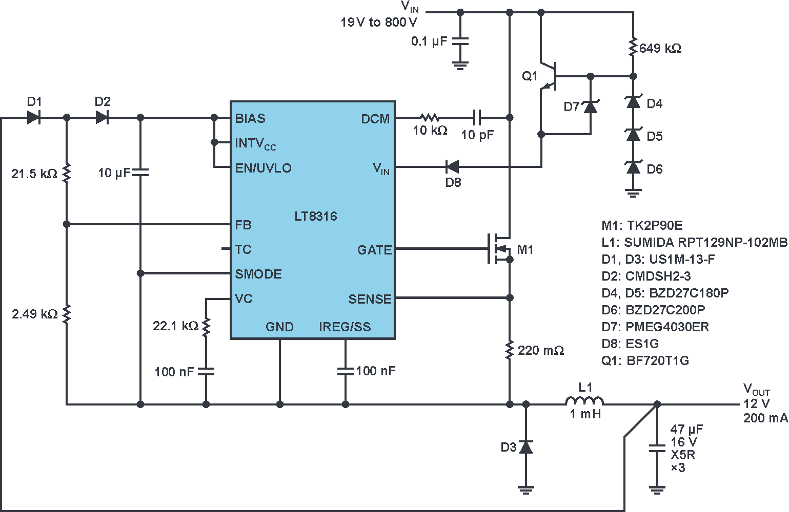

Similar to the flyback converter in Figure 4, a voltage regulator can be added between the supply voltage and the VIN pin to achieve the low start-up voltage of a buck converter. It should be noted that there is a body diode from the GND pin to the VIN pin, which raises the emitter voltage of the transistor and causes base-emitter breakdown. In order to prevent this, two diodes are added to protect the transistor. The low start-up voltage solution is shown in Figure 8.
Schematic of 800 VIN nonisolated buck converter with low start-up voltage.
Figure 8. Schematic of 800 VIN nonisolated buck converter with low start-up voltage.
