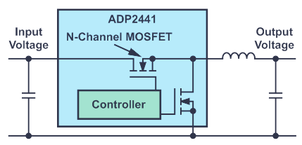

A typical step-down switching regulator with an ADP2441.
Figure 1. A typical step-down switching regulator with an ADP2441.
Other factors may be considered for a more exact calculation, but they are not decisive in the following explanations. The duty cycle of a switching regulator depends on the respective switching regulator topology. A step-down (buck) converter, as shown in Figure 1, has a duty cycle D according to

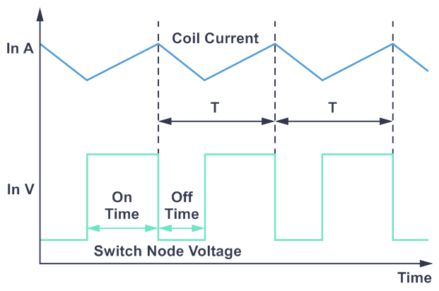

Figure 2 shows an example of switching behavior in the time domain. Here we consider a step-down switching regulator in nonintermittent operation mode; that is, in continuous conduction mode. The duty cycle is independent of the switching frequency. The period T typically lies between 20 µs (50 kHz) and 330 ns (3 MHz). If the values for input voltage and output voltage are the same, a duty cycle of 1 is needed. This means that there is only an on time and no off time. However, this is not possible with every switching regulator. In Figure 1, the high-side MOSFET would have to be continuously on for this. If this switch is designed as an N-channel MOSFET, it needs a higher voltage at the gate than the input voltage of the circuit in order to operate. If there is a certain off time after each on time, as is the case for a duty cycle of < 1, a higher voltage than the supply voltage can be generated quite easily according to the charge pump principle. However, this is not possible with a duty cycle of 100%. Thus, for switching regulators with 100% duty cycle capabilities, either elaborate charge pumps acting independently of the switching regulator MOSFETs must be implemented or the high-side switch shown in Figure 1 must be designed as a P-channel MOSFET. Both also result in additional effort and cost.
Time domain representation of switching in a step-down switching regulator with coil current in CCM.
Figure 2. Time domain representation of switching in a step-down switching

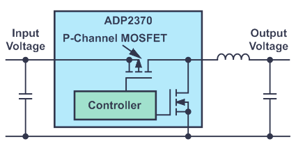

Figure 3 shows a switching regulator, the ADP2370, that permits a 100% duty cycle through use of a P-channel MOSFET as the high-side switch. For this type of buck converter, the input voltage can drop to very near the output voltage. With the P-channel switch integrated into the switching regulator, additional cost is avoided.
Example of a switching regulator permitting a duty cycle of 100%.
Figure 3. Example of a switching regulator permitting a duty cycle of 100%.
If an application requires that the input voltage be able to drop to a level very close to the output voltage setpoint, a switching regulator that permits a duty cycle of 1, or 100%, should be selected.
