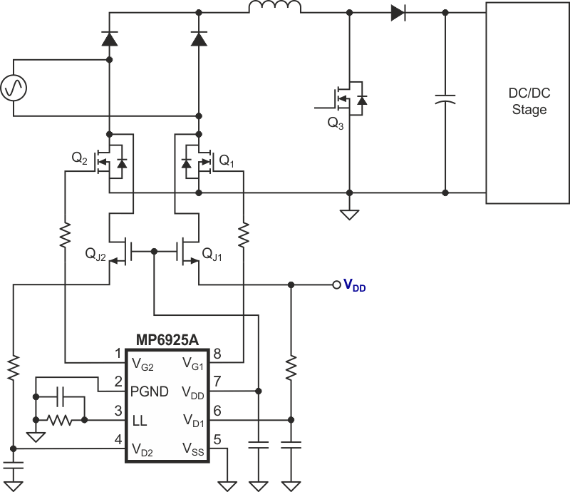

Instead of waiting for the evolution of a new controller IC with bridgeless implementations, another simple and quick alternative can instantly reduce power loss on the bridge. The basic idea is to replace the two low-side rectifier diodes with synchronous rectified MOSFETs. Meanwhile, the rest of the power supply design, including all of the power stages and the controller IC, remain the same. Figure 2 illustrates this concept using MPS’s MP6925A, a dual-channel synchronous rectifier driver that requires very few external components.

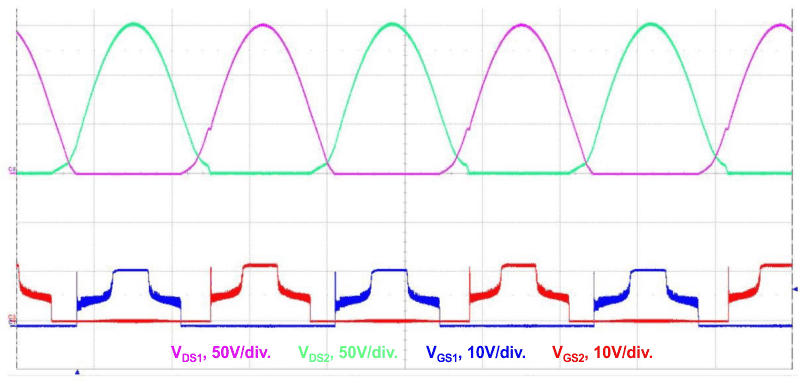

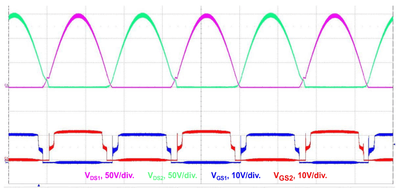

The MP6925A is typically used in LLC converters. It actively drives the two MOSFETs based on the detection of the drain-source voltage (VDS). When setting up the system to replace the low-side diodes in the AC bridge, two high-voltage JFETs (QJ1 and QJ2) are used to clamp a high voltage during VDS detection. When current flows through one of the MOSFET’s body diodes, a negative threshold on VDS is triggered, and the driver turns on the corresponding MOSFET. During MOSFET conduction, the driver regulates the corresponding gate voltage to keep VDS below a certain level, until the current is too low to trigger the VDS turn-off threshold. Figure 3 shows the typical operation waveforms.
Typical Waveforms of a Synchronous, Rectified MOSFET:
Figure 3. Typical Waveforms of a Synchronous, Rectified MOSFET:
a) 115VAC Input, Full Load;
b) 115VAC, 20% Load.
A competitive synchronous rectification driver should have very fast turn-off capability. For example, the MP6925A can turn off the gate with a delay of only 35 ns when driving an equivalent 4.7 nF gate capacitance. As a result, this rectifier can effectively prevent any reverse current on the MOSFET. In addition, these MOSFETs can benefit from “anti-bounce logic,” which prevents the two MOSFETs from turning on simultaneously. This leads to the whole solution being very reliable, without any risk of shoot-through.

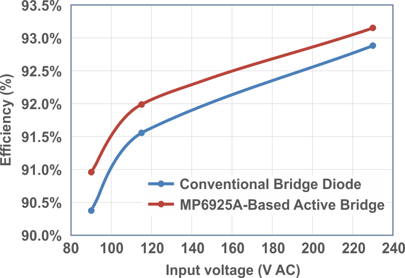

The experimental results were carried out based on a 120 W adapter design, in which 650 V, 99 mΩ MOSFETs are used as the active switch, thus replacing two low-side bridge diodes. Figure 4 shows how efficiency is improved when the diodes have been replaced with an SR MOSFET solution. At a 115 VAC low-line input, the full-load efficiency is increased by 0.43%, which means more than 0.5 W is saved from the total power loss. This is a substantial improvement on both performance and thermal design for most applications.

An active bridge solution based on a powerful synchronous rectifier provides an instant alternative to solve issues with high power loss on the diode bridge in conventional PFCs. By replacing the bridge diodes – which have a relatively fixed forward voltage drop – with MOSFETs, conduction loss can be reduced with a lower MOSFET on state resistance. At the same time, the power loss reduction also simplifies the thermal design. Moreover, when compared to other complex bridgeless solutions under research, this solution is based on a sophisticated IC controller with a low external component count. This makes this low-side active bridge solution a cost-effective, ready-to-use solution for practical applications.
