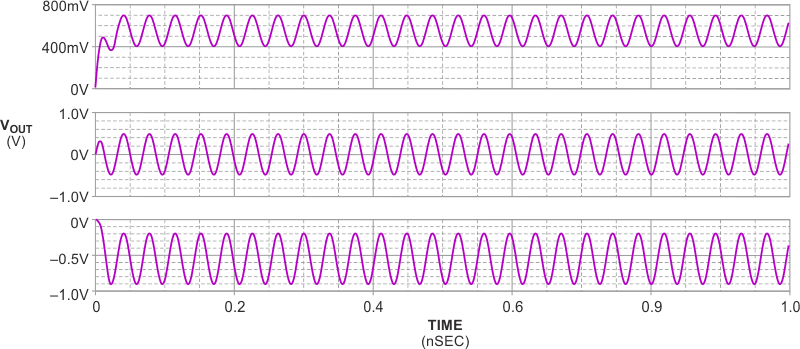

Similarly, you can develop a Hartley oscillator based on a JFET transistor (Figure 3). The simulation and experimental results for the Colpitts oscillator circuit uses a 2N3819, an n-channel device, for the JFET. The PSpice parameters for this transistor are IDSS of 12 mA and VP of –3 V. Simulation shows the voltage gain of the amplifier circuit is 0.3064, and, with C1 having a value of 50 nF and C2 having a value of 114 nF, then
and the circuit oscillates (Figure 4), which also shows the start-up process of the oscillator. The voltage gain also shows that the design meets the start-up conditions on the capacitors:
With C1 having a value of 50 nF and C2 having a value of 114 nF, the circuit oscillates.
Figure 4. With C1 having a value of 50 nF and C2 having a value of 114 nF, the circuit oscillates.
Note that transconductance of the transistor is equal to the value of the slope of the curve iD = f(VGS) at this operating point. Depending on this point, the actual value of the transconductance will be larger or smaller. Confirming this value, when oscillations start up, the curve iD = f(VGS) restricts the amplitude of the output signal due to the reduction of the transconductance when VGS decreases to values close to the pinch-off voltage; in this zone of the curve, its slope and, therefore, the transconductance is smaller. The intrinsic nonlinearity of the JFET transistor limits the gain of the amplifier stage, and no additional circuit stabilizing the amplitude of the output signal is necessary.
