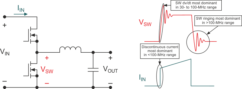

Due to its marked improvement in efficiency over linear regulators, the SMPS has become a crucial component in many system designs. The switching of the power silicon MOSFETs or GaN power devices, resulting in discontinuous currents, are the major offenders that can affect reliable system operation (Fig. 1). The following sections [#55] will outline some of the best ways to reduce the various forms of EMI.
This schematic shows the EMI sources in an SMPS. (Image from Reference 8).
Figure 1. This schematic shows the EMI sources in an SMPS. (Image from Reference 8).

When power switching devices operate on and off, they will generate large discontinuous currents. These currents will appear at the input of a buck converter, the output of a boost converter, and at both the input and output of flyback and buck-boost converter designs.
Discontinuous currents will generate voltage ripple that may be conducted to other parts of the system architecture through conductors coming in contact with each other. Such currents at the converter input should be filtered through an input filter to mitigate voltage disturbances. The output of the power converter also may need a filter to help pass EMI standards.
Common-mode noise is typically more difficult to analyze because it’s usually caused by charge/discharge of parasitic capacitances, which are highest in a heatsink or a transformer interwinding capacitance.

The origin of an electromagnetic field is typically a current containing high-frequency harmonics that are flowing in a loop. Reducing the loop area, the di/dt, or the current peak amplitude will help reduce radiated noise.

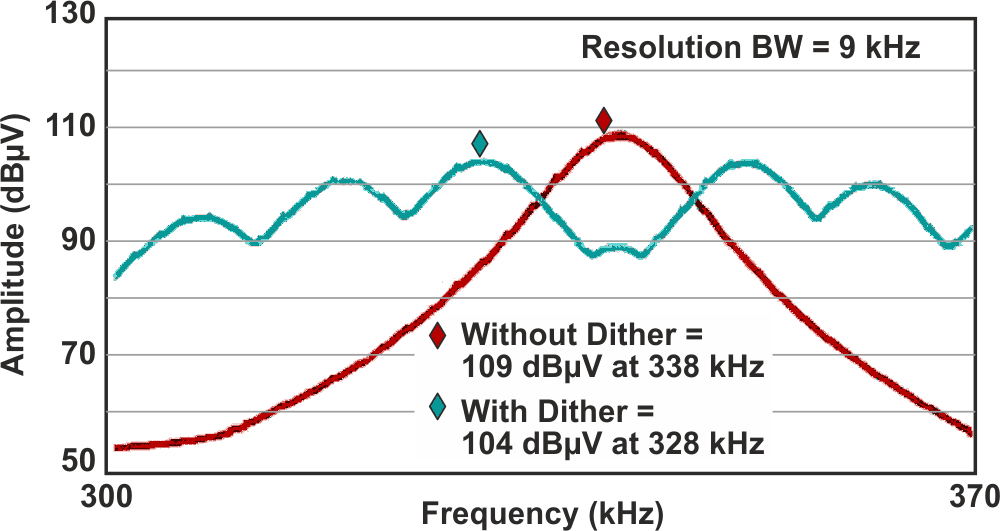

Dithering in Switching Voltage Regulators
Dithering switching-voltage-regulator switching frequency – through the use of spread-spectrum frequency-modulation (SSFM) techniques – will reduce EMI and help designers pass compliance testing when filtering and optimized layout fails to meet EMI standards limits. Dithering [1] slightly modulates a fundamental switching frequency in the switching regulator. Here’s how it works.
The electromagnetic emissions of a switch-mode power supply are spread across many frequencies via a square-wave pulse, where the greatest energy is at the fundamental frequency. Slightly varying the fundamental frequency (using a typical modulation of 3% or so) would modulate the peak switching noise energy, which would be shared among multiple fundamental frequencies. The total electromagnetic energy will remain the same, but the narrowband energy has been decreased so EMI is effectively reduced.
In the example shown in Figure 1, 5-dB peak noise reduction can make all the difference between a fast time to market with standards approval or a lengthy effort to lower noise peaks below standards limits (Fig. 2).
This graph demonstrates quasi-peak measurements with and without dithering around 330 kHz, showing a 5-dB reduction due to dithering. (Image from Reference 1).
Figure 2. This graph demonstrates quasi-peak measurements with and without

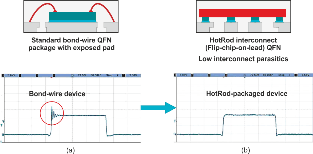

Using Packaging and Pinout to Lower EMI
Many designers may not think about the benefits of selecting a type of IC packaging that can help lower EMI. One great example is packaging for a power MOSFET in a fast SMPS. These kinds of power converters use fast switched voltage slew rates (dv/dt) as well as high current rates (di/dt) that will increase EMI in a system.
Designers can add an EMI filter as a solution. However, before doing that and adding to the size of a design (thus lowering power density), take a look at package technologies that also may help mitigate EMI. What follows are some examples of how to improve EMI with a power MOSFET package design.
Setting up parallel pins for the input power and GND pins will enable symmetrical placement of high frequency input capacitors. In addition, equivalent parasitic loop inductance of the two equal and parallel inductances are halved.
Bond wires in a QFN package can sometimes be eliminated via the use of copper pillars and a flip-chip interconnection between the lead frame and the die (Fig. 3).
This typical QFN package uses bond wires to connect the die to an exposed pad where the power switch exhibits significant ringing (a). An improved package utilizes copper pillars and a flip-chip interconnection from the die to the lead frame, which eliminates a ringing in the power switch (b). (Image from Reference 8).
Figure 3. This typical QFN package uses bond wires to connect the die to an exposed pad where the power switch
Circulating input currents will create opposing magnetic fields that result in H-field cancellation and reduced radiated emissions. So, by creating a symmetric layout of high di/dt input loops, the magnetic fields generated (of opposing directions) can cancel each other.
Another way to reduce EMI for the package is to place a continuous ground plane for return current beneath the two inductor loops on another PCB layer, such as layer 2, which is right below the top layer power circuit.

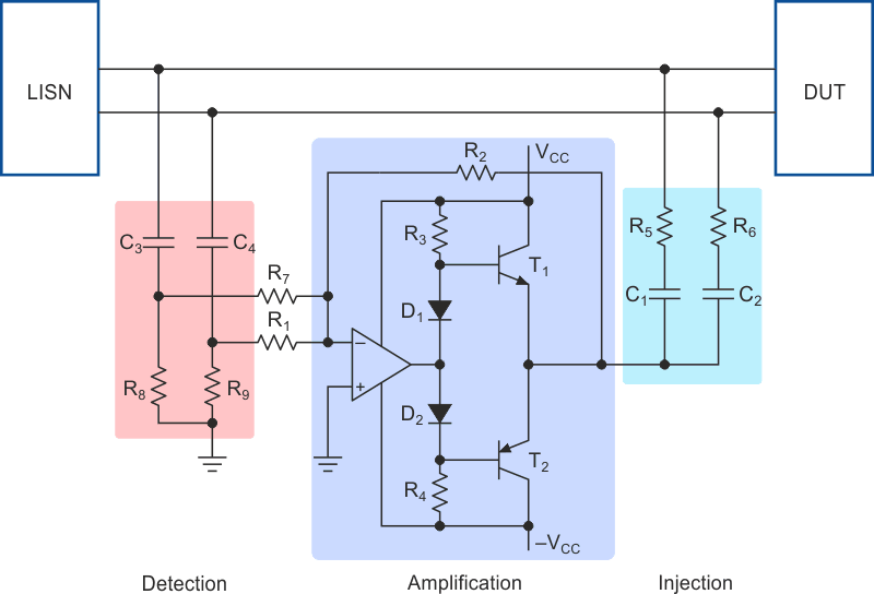

EMI filters in a high-power-density power-supply architecture
It’s essential to minimize the size of an EMI filter in a high-power-density power supply. [7] A filter design that has no magnetic components is more compact, thus achieving good power density.
For instance, the filter design in Figure 4 uses voltage detection and a current injection topology without magnetic components. To enhance the output current and power of the filter as well as improve insert loss (IL), a push-pull power-amplifier circuit is used behind the output of the amplifier so that the output current is large enough. This filter design is stable enough to replace a passive EMI filter.
This high-performance filter design, with no magnetic components, can support high output currents in the order of 60 A. (Image from Reference 7).
Figure 4. This high-performance filter design, with no magnetic components, can support high output

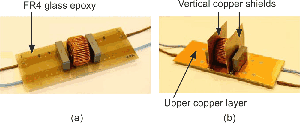

Shielding an EMI filter as a last-ditch effort to control conducted EMI
A differential-mode (DM) EMI filter (Fig. 5) may produce conducted EMI interference in a power-supply system.
Figure 5. Shown is a Pi-type EMI filter (Image from Reference 9).
A copper shield [9] placement below the DM filter may help (Fig. 6a). When all else fails, add copper layers to the top and bottom of the PCB plus two vertical copper shields on either side of the filter (Fig. 6b).
Two different configurations for the DM EMI filter: In (a), the filter is on top of a single-copper-layer PCB with a distance of 3.5 mm between each of the filter components. In (b), the filter is atop a double-copper-layer (top and bottom) PCB and two vertical copper shields, with 3.5 mm between each of the filter components. (Image from Reference 9)
Figure 6. Two different configurations for the DM EMI filter: In (a), the filter is on top of a single-
