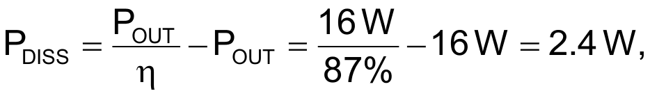

A few basic calculations can help you estimate a Class D-amplifier IC's die temperature. For example, consider an amplifier that operates at an ambient temperature of 40 °C, has output power of 16 W, and has 87% efficiency. Specified thermal resistance from the IC's junction to ambient air is 21 °C/W. First, calculate the Class D amplifier's power dissipation:
where PDISS is the dissipated power, POUT is the output power, and η is the efficiency. Use the power dissipation to calculate the die temperature, TC, as follows:
which is within the device's maximum junction temperature of 150 °C. A system seldom enjoys the luxury of operation at a 25 °C ambient temperature, and it's important to base these calculations on a reasonable estimate of the system's actual internal ambient temperature.

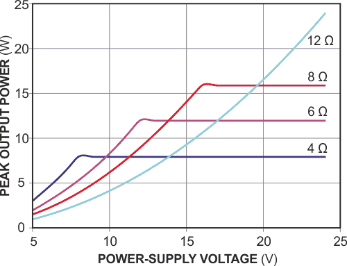

The on-resistance of a Class D amplifier's MOSFET output stage affects both its efficiency and its peak-current capability. Reducing the peak load current reduces the infinite-impulse-response losses and increases efficiency in the MOSFETs. To further lower peak currents, choose the highest impedance speaker that delivers the desired output power within the voltage-swing limits of the Class D amplifier and its supply voltage. In Figure 4, a Class D amplifier with an output-current capability of 2 A and a supply-voltage range of 5 to 24 V goes into current limiting with a 4 Ω load and a supply voltage of 8 V for a corresponding maximum continuous output of 8 W.
Selecting an optimal impedance, such as 12 Ω, and supply voltage, such as 15 V, maximizes output power and prevents current-limiting-induced distortion.
Figure 4. Selecting an optimal impedance, such as 12 Ω, and supply voltage,
induced distortion.
If 8 W represents an acceptable output power, consider using a 12 Ω speaker and a 15 V supply voltage. The peak current limit then occurs at 1.25 A, with a corresponding maximum continuous output power of 9.4 W. Furthermore, the 12 Ω load operates at 10 to 15% higher efficiency than the 4 Ω load and thus lowers the IC's power dissipation. Actual efficiency improvements vary among Class D-amplifier ICs.

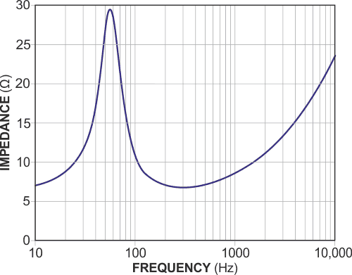

The electrical impedance of this nominally 8 Ω, 13-cm-diameter, wide-range loudspeaker varies significantly with frequency.
Figure 5. The electrical impedance of this nominally 8 Ω, 13-cm-diameter, wide-range
To complicate matters for the designer, a loudspeaker behaves as a complex electromechanical system that presents a variety of resonances across its frequency range and exhibits its nominal impedance only within a narrow frequency band (Figure 5). Over much of its audio bandwidth, this loudspeaker's impedance exceeds its nominal value of 8 Ω; adding a crossover network and a tweeter may reduce the total load impedance below the nominal value. Keep the load impedance's behavior in mind when you consider the amplifier's power-supply current and thermal-dissipation capability.
