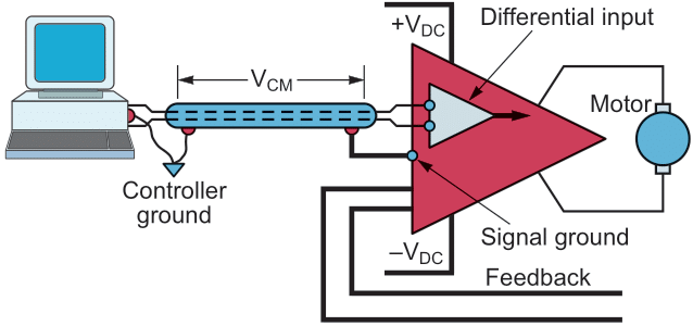

However, even a servo with a differential input (see schematic in Figure 2) needs a certain level of common mode rejection (CMR) because there will usually be some VCM (A unit’s ability to reject VCM rests in its CMR, usually expressed in dB. Generally, for systems with proper grounding, CMRs of 60 dB or more will do the trick.) VCM can range from a few millivolts to tens of volts. Therefore, designers add circuits to attenuate the effects of VCM.
| Figure 2. | Servoamps with differential inputs and a high degree of common mode rejection are immune to differences in ground voltages. |

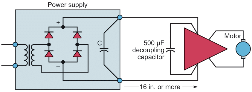

In turn, the fast current increases combined with inductance from leads more than 16 in. long can cause enough of an inductive kick (voltage spike) to create amplifier problems. To solve these, engineers add a 500 µF decoupling capacitor at the amplifier terminals (as shown in the schematic in Figure 3). This capacitor should be connected as closely as possible to the servoamp’s power semiconductors. So, it should be connected across the amplifier terminals, not the power supply terminals.
It is also imperative that the technicians adhere to the servo manufacturer’s instructions on grounding practices.
| Figure 3. | If the servoamps lead are longer than 16 in., a decoupling capacitor is still often needed at the servoamp even if there is a large capacitor in the power supply. |

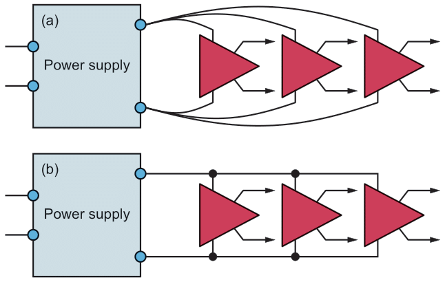

To minimize an amplifier’s interference with another, separate power cables should run to amplifier (as in the upper schematic in Figure 4.) That is because servoamps draw appreciable currents – typically 20 to 50 A. Plus, these currents are a series of fast rising pulses that may create mutual interference between amplifiers (crosstalk). This crosstalk, in turn, often impairs system performance.
| Figure 4. | To eliminate crosstalk between amps, use individual pairs of wire from the power amp to each amp (upper schematic) rather than using a dc bus common to all amps (lower schematic). |
Therefore, daisy-chaining the amplifiers to a common dc bus (as in the lower schematic in Figure 4) exposes downstream amplifiers to all of the power line-voltage disturbances created by upstream amplifiers.

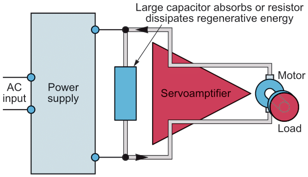

For servos operating on conventional ac power, the most popular methods for absorbing or dissipating the energy are:
- Return the energy to a capacitor or resistor connected across the dc bus between the power supply and amp (see schematic in Figure 5). This is the most common method used in industrial applications.
| Figure 5. | In this setup, the servo becomes a regenerative brake, converting kinetic energy into electricity. The electricity is sent through the servo to the dc bus where it charges a capacitor. |
But engineers must be aware that regenerative energy can be a fire hazard if the amount of returned energy is more than the capacitor or resistor can handle. And if there is too much kinetic energy powering the regenerative braking, the capacitor could overcharge and activate the servoamp’s over-voltage shutdown circuit.
The motor and load are then no longer under servoamp control and will coast until friction absorbs the kinetic energy. Or, more likely, the motor and load will slam into mechanical stops and possibly damage equipment and cause injuries. Therefore, it is imperative to provide adequate capacity for the capacitor or resistor.
