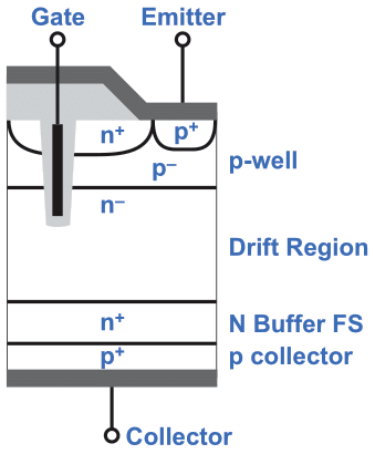

An IGBT is a semiconductor transistor, or semiconductor switch that is constructed with four alternating layers (P-N-P-N) of semiconductor material (Figure 1). When the correct voltage is applied to the gate of the device that it is able to conduct current – when this voltage is removed, conduction is halted.
Field Trench Stop IGBT Structure.
Figure 1. Field Trench Stop IGBT Structure.
Since their inception, IGBTs have been honed and improved, especially with regard to improving switching losses as well as creating thinner structures. Nowadays, IGBTs often combine a trench gate with a field stop structure as a means of suppressing parasitic NPN characteristics within the device. Once this is achieved, the conduction losses and saturation voltage are reduced which brings benefits such as enhanced power density.

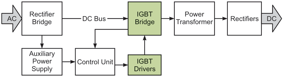

In a typical welder, the AC mains, single or three-phase, is rectified to form a DC bus voltage (Figure 2). The rectifier also powers a small converter that generates the voltage(s) needed for the control unit. The DC bus voltage powers the inverter which will normally have a nominal output voltage of around 30 VDC. However, during use, this can double under open load operations and collapse to almost 0 V (effectively a short circuit) as welding arcs are being struck.
Overview of a typical welding machine.
Figure 2. Overview of a typical welding machine.
A number of different topologies are suitable for use in inverter-based welders. However, the most common include full-bridge (FB), half-bridge (HB), and double-switch forward (Figure 3). In FB and HB topologies, the switching frequency is tens of kilohertz, normally in the range of 20 – 50 kHz. The duty cycle is controlled based upon the load level and output voltage. In terms of the control scheme, this is usually constant current.

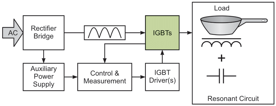

Replacing traditional electric heating elements that get hot and transfer thermal energy to a saucepan / pot, induction stove cooking uses the principle of exciting a coil of wire to force, or couple, current to circulate within the base of the pot (Figure 5). For induction cooking to work, the base of the pot has to be physically close to the coil and only certain metals are suitable – a material with high magnetic permeability is required.
Overview of a typical induction stove circuit.
Figure 5. Overview of a typical induction stove circuit.
The theory is similar to a common power transformer with the coil being the primary, and the base of the pot being the secondary. It also has much in common with modern inductive charging technologies.
The heat needed to warm the pot comes from the circulation of eddy currents in the bottom layer of the pot or, more specifically, resistance to these currents flowing. Using inductive coupling, around 90% of the energy is transferred for the creation of heat in the pot. A typical smooth top non-inductive stove would only transfer around 70% of the energy, so the losses are reduced by a factor of three.
The topology used is not too dissimilar to the welding circuit. The mains AC is rectified to drive the inverter and a small auxiliary power supply for the controller. The inverter induces a current into the copper coil, thereby generating an electromagnetic field that induces the Eddy currents in the pot. The heat generated is equal to the electrical resistance of the pot base, multiplied by the square of the induced current – known as the ‘Joule effect’.
Unlike welding machines, the control scheme for induction stoves is often a variable frequency scheme. While this is a simple approach, the challenge lies in the range of frequencies required to control output power over a wide range.

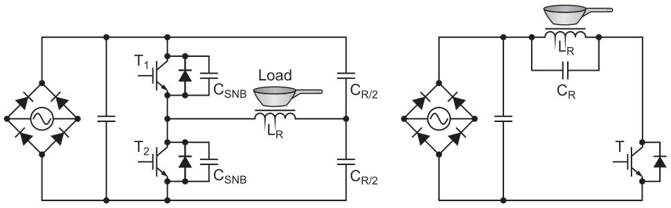

Resonant converters can operate at high efficiency, even at the high frequencies that inductive stoves require. Therefore, resonant tank-based converters are commonly used in this application – especially resonant half-bridge (RHB) converters and quasi-resonant (QR) inverters (Figure 6). RHB converters are particularly valued due to the wide load range they can handle. Often, advanced control techniques such as zero current switching (ZCS) or zero voltage switching (ZVS) are used to ensure power losses are kept to a minimum.
Examples of typical RHB and QR topologies.
Figure 6. Examples of typical RHB and QR topologies.
QR converters are frequently used in low-power (sub-2 W peak power) inductive stove applications due to the cost-effectiveness of this topology.
