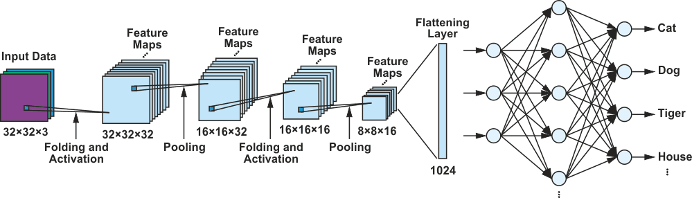

The CIFAR network, which is discussed in the first part of the series, is made up of different layers of neurons, as shown in Figure 1. The image data from 32 pixels × 32 pixels are presented to the network and passed through the network layers. The first step in a CNN is to detect and investigate the unique features and structures of the objects to be differentiated. Filter matrices are used for this. Once a neural network such as the CIFAR has been modeled by a designer, these filter matrices are initially still undetermined and the network at this stage is still unable to detect patterns and objects.
CIFAR CNN architecture.
Figure 1.  CIFAR CNN architecture.

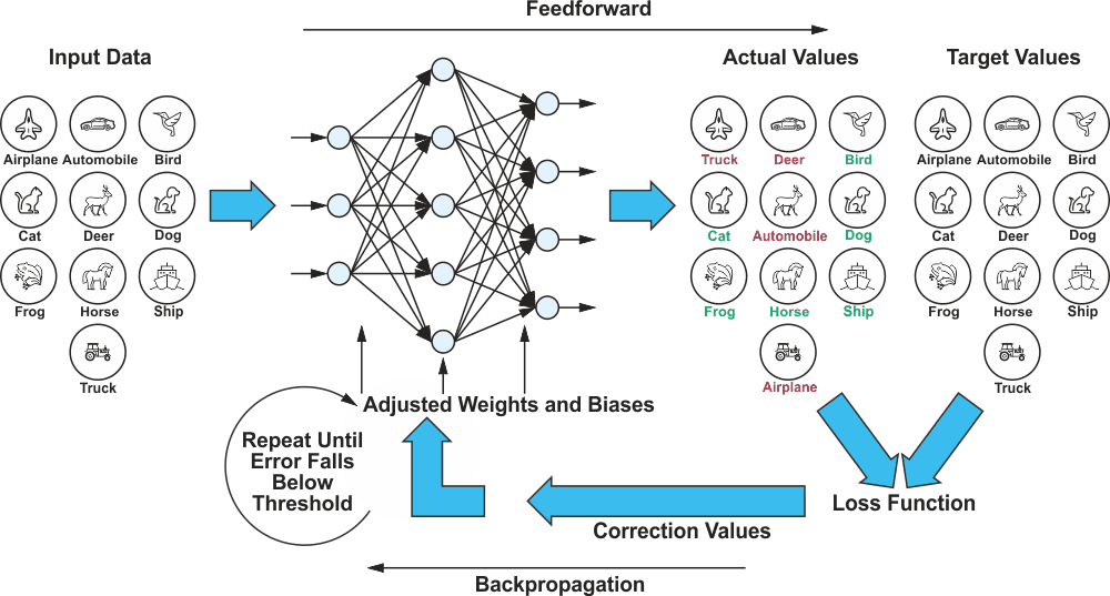

Training data is required to train a network, and later, a similar set of data is used to test the accuracy of the network. In our CIFAR-10 network dataset, for example, the data are the set of images within the ten object classes: airplane, automobile, bird, cat, deer, dog, frog, horse, ship, and truck (Figure 2). However – and this is the most complicated part of the overall development of an AI application – these images must be named before training a CNN. The training process, which will be discussed in this article, works according to the principle of backpropagation; the network is shown numerous images in succession and simultaneously conveyed a target value each time. In our example, this value is the associated object class. Each time an image is shown, the filter matrices are optimized so that the target and actual values for the object class match. After this process has been completed, the network can also detect objects in images that it did not see during training.
A training loop consisting of feedforward and backpropagation.
Figure 2.  A training loop consisting of feedforward and backpropagation.

Learning is done in two steps. In the first step, the network is shown an image, which is then processed by a network of neurons to generate an output vector. The highest value of the output vector represents the detected object class, like a dog in our example, which in the training case does not yet necessarily have to be correct. This step is referred to as feedforward.
The difference between the target and actual values arising at the output is referred to as the loss and the associated function is the loss function. All elements and parameters of the network are included in the loss function. The goal of the neural network learning process is to define these parameters in such a way that the loss function is minimized. This minimization is achieved through a process in which the deviation arising at the output (loss = target value minus actual value) is fed backward through all components of the network until it reaches the starting layer of the network. This part of the learning process is also known as backpropagation.
A loop that determines the parameters of the filter matrices in a stepwise manner is thus yielded during the training process. This process of feedforward and backpropagation is repeated until the loss value drops below a previously defined value.
